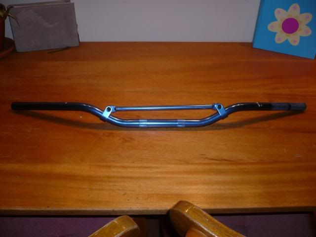

Right then today i really haven't done that much on it due to other commitments, however help a friend empty his newly acquired garage and found some items!!! Oh and fitted a ground anchor now she rolls thought it would be a good idea. Managed to polish and clean it a bit but not a lot i am afraid i will get more done tomorrow, promise!
as promised some pics>>>>
oh and fitted a light so i could work in the dark!!!!
found these in his garage

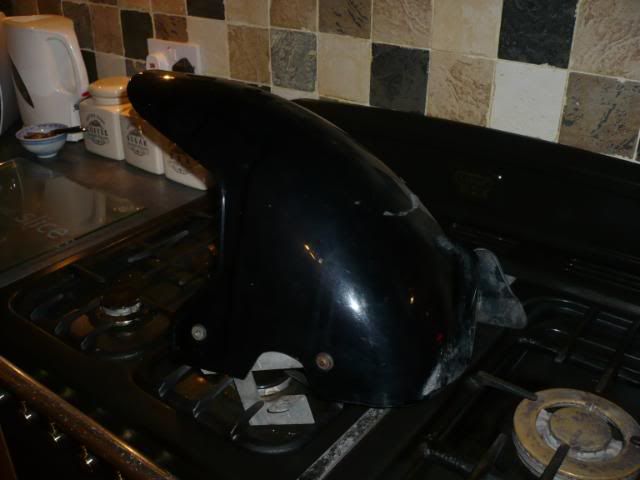

this also which amazingly is for a SV650!!
does need small repair on one of the bolt holes does anyone know a good repair for plastic or should i fibreglass it???

Default Re: sv650 stripped and being cleaned/polished
Plastic welding?
Old 14-11-09, 07:19 PM   #467
liamsimpson
Plastic welding?
forgive me for being thick but does that require any equipment???
Old 14-11-09, 07:29 PM   #468
Soldering iron & off cuts of cable ties. Practice a bit first
Old 14-11-09, 07:47 PM   #469
liamsimpson
ok many thanks i will have a go!
Old 14-11-09, 07:53 PM   #470
Do it on the side that won't be seen.
Have a look a Svrory's post about his painting job, he was using so pins to strengthen the join
