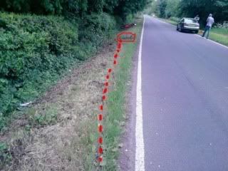

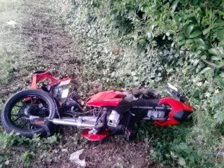

A couple of photos at the scene of the accident.
The red line shows the tyre marks where he went off the road. You probably cant see, but I've followed the tracks and the only thing that he hit is the slight bump in the mud that is circled.
This picture shows just how strong the Derbi is!! forks look straight but frame snapped. All from a 35-40 MPH off on soft earth
Spoke to the local Derbi dealer today who said they would inspect the frame as long as it was still under warranty. 2 year warranty and it's two years old today

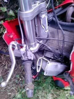

Close up up frame damage.
Don't think it is clear on here but the weld on the bottom of the headstock (which is at the top on this photo!) was darker than all the other welds. Would this mean that it had already cracked?
Old 27-05-09, 10:21 PM   #39
maclovin
Default Re: Nephew Down.
would say so any cracks i have encounted at work . a die break caused by one off impact is all the same , but if its a weak fault point that is a long term thing it tends to oxidise causing a darker grey
