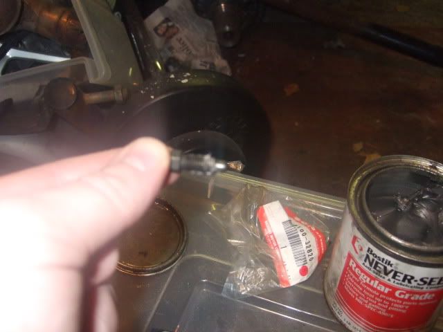

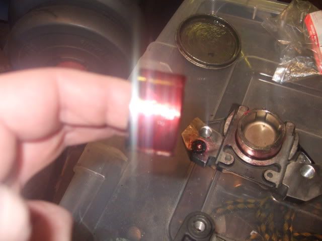

Well time for the rebuild-
second coat dried, so put it back together-
start off with this-
small smear of rubber grease in recess prior to fitting seals
then fit the seals
piston time- again a smear of rubber grease
then gently push into the caliper
two halves back together with plenty of copper grease on the caliper bolts(i always fit them in the back of the caliper first to get the threads a good coating of grease)
same with the bleed nipples, then fit it all together.
from the above pic you'll see that the other half of the caliper has had the brake pad pin holes drilled through, much easier for future brake pad changes.
pins and holes get good dose of copper grease and then fitted, retaining pins fitted,bleed nipple covers fitted then whole caliper gets a wipe with a copper grease rag(found that it tends to stop the caliper getting grotty with road carp)
add pads,fit dust cover, fit to bike and bleed, then ride like a loon and hit the anchors-you know that the back one will work for a while atleast
hope this maybe help anyone who doubts they can service there own calipers.
H.
