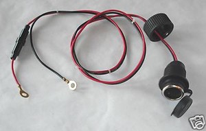

Bought a cigar socket and a connector for the optimate. Now when I want to use the cigar socket I open the rear seat connect it the the optimate connector that runs from the battery and bingo. When I don't use it I just unconnect it. No flat battery.
Weatherproof Fused Eyelet Lead for Optimate 4 charger.
The cigarette socket connects to this under the rear seat.
12v Motorcycle Chassis Cigarette Socket.
Snip the ends off and remove the fuse, replace with an optimate connector from maplin.

+1 Did the same the other day when I wired my Sat Nav.
Used a male optimate plug and soldered the terminals. I plug this into the female optimate lead so it powers the Sat Nav whilst I'm going along, but I also bought a Optimate cigarette power socket, so I can charge my phone up or connect anything else via this
Optimate plug & terminals also available on Evilbay
