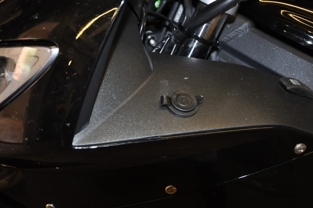

Its not complicated at all and its the correct way to do it imo, if you took it to an automotive technician to have one done im sure it would be like this, plus i was given a load of relays so had most of the stuff.
Factory ones will be stand alone as well.
Check out any car cigarette lighter socket, they are always wired directly to the fusebox whether switched by the ignition or not... no relays involved unless it's some piece of cr4p made in Italy, and we know all about how good their electrics are. If it's good enough for Mr General Motors, Mr Volkswagen-Audi and Mr Ford, then it's good enough for me.
Mine's a waterproof in-dash mounted socket rated at 120W wired directly to the battery with a 10A fuse inline, because I mounted it in a place where I'll be able to spot anything plugged into it when I leave the bike overnight, and I want to be able to use certain plugged in items without having to have the ignition switched on. I thought having one under the seat would be bloody annoying when I'm touring as it means unstrapping everything from the pillion seat then restrapping it down again twice every time I wanted to charge my phone or anything else. With it where it is I can just run the charger lead into my tankbag and charge it up as I ride.
If you install a quality one correctly they look like they belong on the bike and don't knock anything off the value.
http://cgi.ebay.co.uk/cigarette-ciga...item3f016bd8ef
Horses for courses, i prefer to do it my way cos i know it wont give me any grief.
You've added another component into the equation, thereby doubling your chances of grief.
As my old mentor told me when I was an apprentice "Keep it simple, stupid"

The problem you get when not using a relay (accepted if wired directly you dont have the same issues) is the contacts wont be substantial enough to support switching the 12v socket as well.
Its a no brainer imo, relays are dead cheap to quickly change over if it goes pete tong, igntion circuits / components wont be.
I accept if you're only pulling 120 watts then it shouldnt cause a problem, but my tom tom power cable pulls a lot more than that, so it just not worth the risk.
I could easily run 5-8 amps through mine with no issues.
BTW mine does look neat so wouldnt de value the bike.

Nice job..how did you install it looks so neat?

How did you drill the hole in the instrument surround panel without it splitting/cracking?..job you have done looks like it was there in the first place..great job
Old 17-07-10, 12:10 PM   #37
Default Re: Towzatronics 12V (Cigarette) Power Socket
Hole saw, piece of p1ss.
It has a 6mm pilot drill which guides the cutter, i did remove it from bike though just to be safe.
Granted if you run it through the ignition switch then you might encounter problems so a relay is needed, but I don't see the point of doing that. I want to be able to use mine to pump up airbeds and suchlike, so having the ignition on would be a pain.
I like that, nice and neat like it belongs there.
The plastic used for the surround panels is usually quite pliable and takes some unearthly force to crack or split it. Just drill carefully after measuring up and checking at least three times. If you need a hole that has a flat on one side, file it out carefully checking with the socket regularly to make sure you don't file too large a hole.
