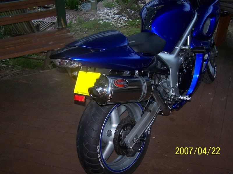

Richie- f**&&&in loads of swearing mate.. cant believe it took me so long- mind u I had loads of brews and sits by the pond and the telly in the shed distracted me.. but it took me all yesterday and half of today for the pipe and back end- oh and about 2 hours the last time when I took the snow shovel off..
Jim- I wondered that mate.. TBH the back light gives enough light off I reckon.. but hey ho.. just got some grommets on advice of Ape.. so maybe half a grommet at the plate side of the hole will tilt them back toward the plate.. mind yu the plate can be bent nice n easy and angled. so wewill see
hey it might all fall off yet when I ride it.. wich worriesme cos its over the back wheel..! no- it is bolted on and the plate bracket slides through two slots so wont fall off.. (I may just slip a cable tie beneath them inside the under seat bit and just tether them to something as a fail safe..
plus I utilised the clips at the rear on the rear fairing- the 2 corner ones so they are screwed on and I used threadlock.. loctite..

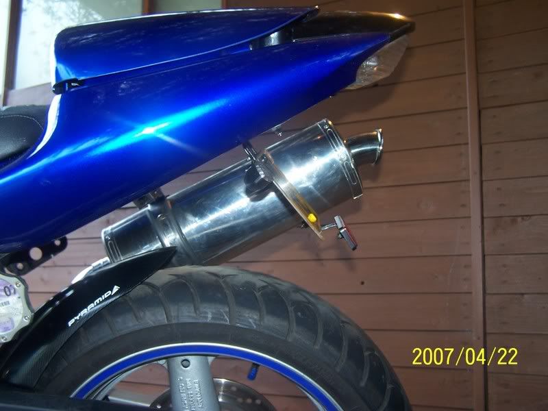

Ape -
this is my home made temporary bracket hangar..just bolted to the sub frame.. may not be strong enough yet but will be self evident if it breaks.. the can stays on without it but not to ride.. so if I ride I will stop a few times and check for wear n tear..
now I know it works I can make a better one ..
took ages to make the spacer- it kept catching on the rear side panel.. I made it from something I had..- it really neds some angle iron I think.

Ok final pics- thank god you say !.
off to go and get the crud off my hands now and pop a blood blister.!!
phew all done- lets see if it all falls apart on my first rideout eh

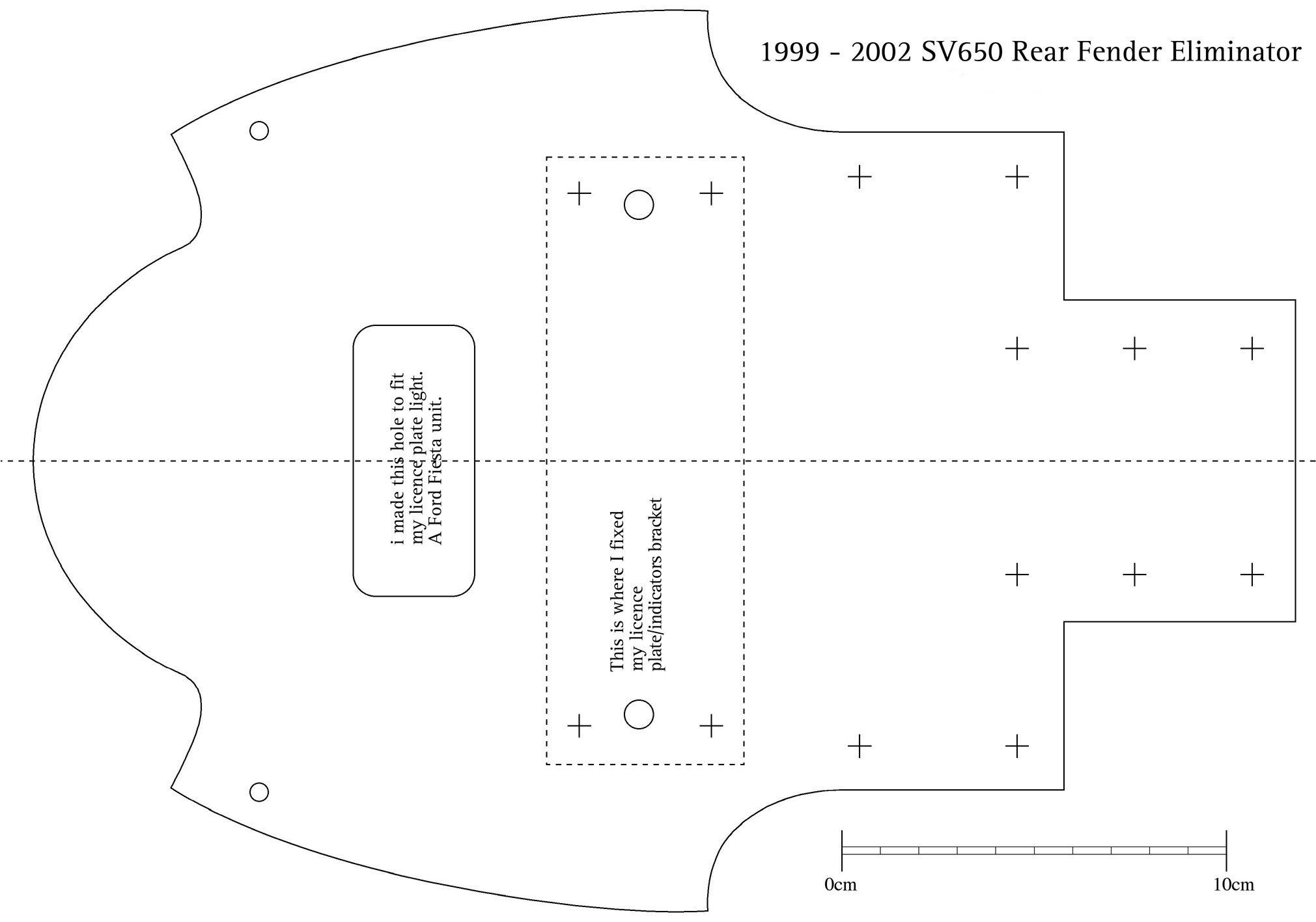

Err sorry to say, what did you use to cut that up? did you use the template? Mine looks neater than that. Where did you end up putting the alarm and CDI box, i was able to fit them both under the left panel by making a bracket for the CDI unit and bolting both the alarm and CDI to the sub frame.

http://www.pyroserve.com/tsm/curvey_...eliminator.jpg

ooooo I thought it was quite neat.. lol ..
I have bent the edges up to form a lip..
I saw your thread about puttingthe cdi etc at the side.. but I have an alarm in there too. and wasnt too sure about weather and the cdi .. I can get everthing under the seat I need anyway ..
