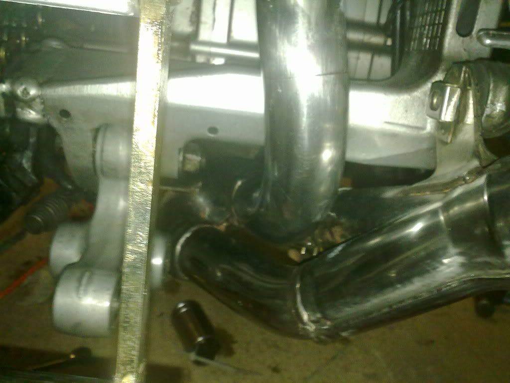

pics and a video of it running
fixed exhaust stud (cost me nothing) thanks very much to my college for lend of the kit
cleaned
air box and stacks
shiny down pipes on
video
