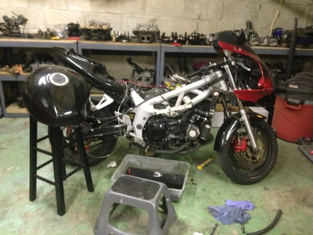

So everything came together then just had to start testing....... So first finish wiring up the starter relay I moved!!! (Yes it's messy in there!!)
I did this as jacking up the rear meant my infills no longer fit so I had to tidy out under there, looks prettier now but bad pic I guess
For giggles here's how I set it up to test.....!!!
So the carbs didn't blow out under 4/5psi of pressure from the fuel pump but strangely my bike fires straight up now and I mean click brrrrm!! The fuel pump is a great modification even for non boosted bikes in my opinion, no three turns of the engine just click brrrrm it's great!!
So yes carbs held the pressure fine and no choking the system.
First fire up was a nightmare though, smoke everywhere from the exhaust wrap then watching the turbo at idle it was struggling to turn. Admittedly I expected it would a little given its designed for a 1500cc and is only taking 300cc pulses at idle but this was seriously slow.....
However the wastegate was wide open as I've not fitted the custom actuator nor made it yet, so fire it up again and yup turbo spins ok at idle, slow yes but as I said that's expected!
Right now the more important part, the carbs are all piped up for increase dynamics
so it was throttle time......
Wait for it....
Wait for it....
BRRRRRRRRRRRRM to 9k throttle closed 1psi of pressure and......
PFF-FT-FT-T-T yes we have turbo chatter!!!!
No flooded carbs, no dip off, nice clean jump threw the range and chatter on the release!!! I'm so excited, yes the next jump is to put it all together and take it for a test rude but baby steps, baby steps!!!

Ok my bad, I just looked through and I got pictures muddled up. The picture I listed as a test picture was the test for the return feed lol this is the correct picture!!!!
That's better!! In this one the intercooler etc is attached!
