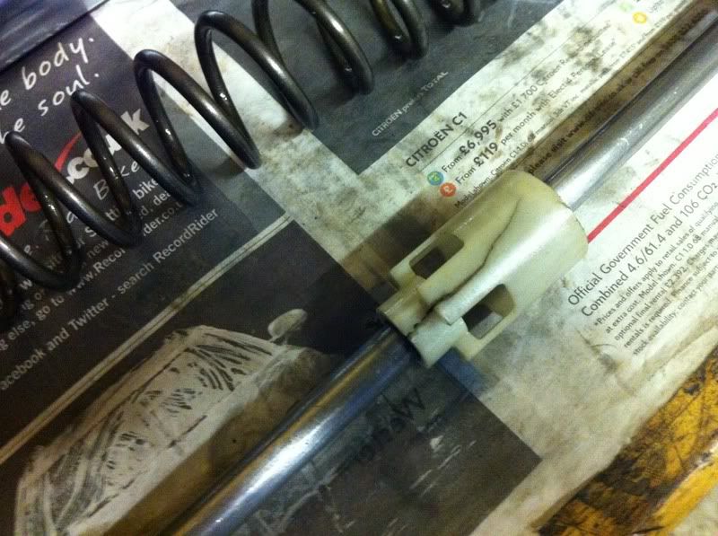

I'm onto what should be the more mundane jobs now, such as fixing a leaky fork seal.
The eagle-eyed among you will have spotted that the plastic bush that sits between the spacer and the spring is stuck on the cartridge rod. Why's that? I wondered. Here's why.
And a better one.
That guide is held onto the rod by a couple of snap rings. As it's cracked, it had ridden up onto the top ring and expanded, jamming that other bush onto it when I disassembled the fork.
I took a look at the parts fiche and it's not a separate part. It comes as part of the cartridge rod assembly (which costs a squillion pounds, obviously).
I couldn't really work out what useful purpose that part was serving so I've asked on the RGV forum and apparently it commonly breaks, doesn't do very much and can be safely dispensed with.
Off to the bin it goes.

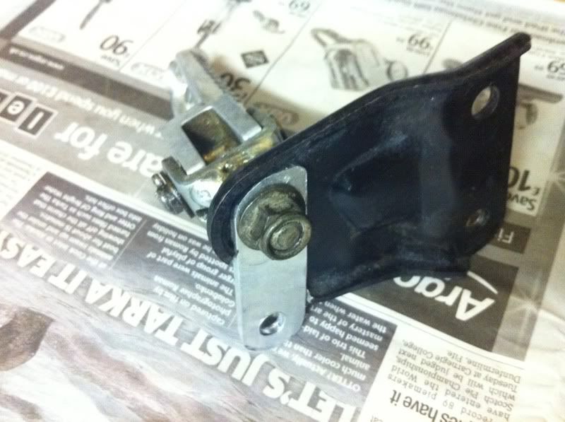

Didn't do much over Christmas but have now put the rest back together with a couple of changes.
After ages of watching ebay I finally got some pillion pegs & brackets. I got these really just to make it a bit more stock and MOT-able. I don't think I know anyone daft enough to actually get on the back.
Putting them on created another problem because the unsupported Tyga stingers were so close they were rattling against the peg hangers - probably why the hangers were missing in the first place.
I ground a wee bit off the lip and put in an aluminium bracket for an exhaust hanger. This was the first effort with the bracket facing to the rear. It looked better facing forward, with the exhaust clamp closer to the front of the stinger, so I changed that later.
Painted it all up and got a couple of these offset clamps from Tyga.
Nothing terribly clever there, but does the job and looks alright I think.

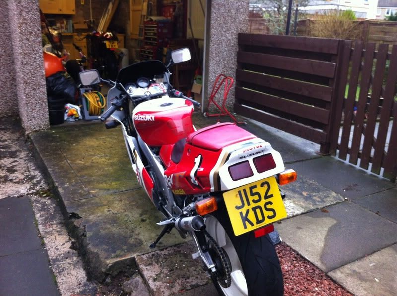

A return to stock indicators and full size number plate at the back. Reflector added to keep things legal.
The smoked screen that was on the bike was cracked and didn't fit properly. The previous owner gave me a few spares with the bike, including this black screen. It does fit properly but was pretty scratched up. The worst of the scratches polished out so I've used it.
It's not what I would have chosen, but it actually looks alright.

Just needs an MOT now. I was going to get it done before I stripped it but there was a few wee niggly fails so I left it.
Might get it done next weekend. Then run in the new pistons for a couple of hundred miles and we're off.
