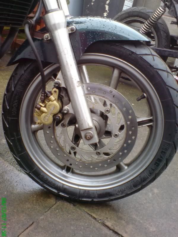

Couple of updated pics.
Brembo front caliper fitted.
My new paddock stands (early Christmas pressie off the kids ). I have tidied up all of the wiring that used to sit in the headlight bezel, this now lives under the fuel tank and also cut off the rear footpegs.
Bridgestone Bt090 Tyres fitted.
All that needs to be done now is remove the OE stands & she is ready for the track.I have hit a major problem with the rear wheel, no one seems to have any 2nd hand rear brake discs, so I am going to run with the drum brake for a couple of track days until I can afford a new disc (£95 + vat ) and the footrest hanger & brake lever are different on the later models, so need to find one of them. Never mind it will come good sooner or later.

Old 07-12-07, 05:58 PM   #18
coggers28
Default Re: My new Playtoy
Bike looks good ' it's getting there.
You may want to change:
Front brake hose for a braided one ( keep the original rear one on though )
Front brake fluid for dot 5.1 higher boiling point.
Front fork oil , 10w with i think a 192mm air gap ( speak to Dave)
Remove center stand , other wise you'll grind it out or worse it'll dig in and flip you off.
Remove original fuel filter located in tank on fuel tap because they are prone to getting blocked, fit an in line one on.
Tyre pressures , i use 30 Front 32 Rear , but it's up to you on how you feel on the bike.

Stand has gone I will sort out the other bits & bobs after tomorrow. If it's wet it will hopefully give me some feedback into how it feels, plus it should show any problems.

Done my track day & it has pulled a couple of little problems. The clutch is slipping in 5th & 6th, so am going to dump the oil & use some better quality stuff.
1st session was a bit scary, went out with std pressures in new tyres, so scared me to death, lowered them a little & felt a bit better. I will try upping them on the next one to see if that makes a difference.
