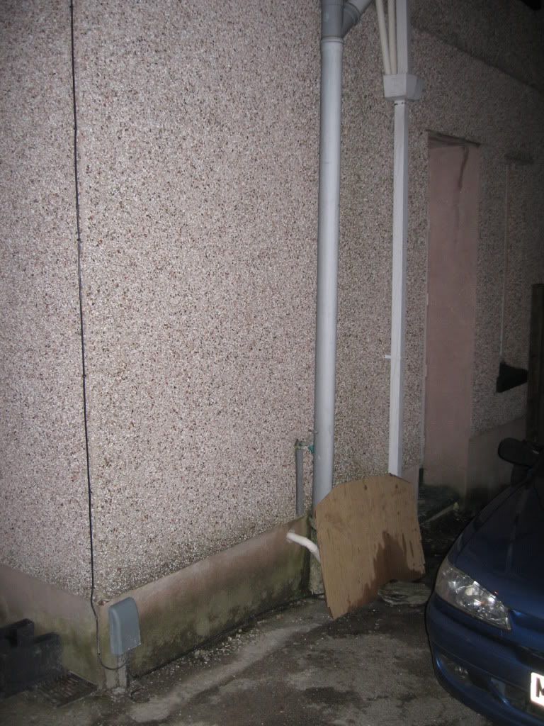

phil24_7
Default Re: Soil stack question
Here's the pic of the soils stack. I want it moved to the front of the house. The drain runs down the side of the building, between the building and the car.
if you make a double extension (second floor as well) you could run the pipe from the toilet under the floor of the extension and move the stack to the outside of the extension which would save having to route the pipe from the toilet any other way since you cant drill a 4" hole for it through joists (if there in your way for running it to the front of the house) and the stack stays "hidden" down the side of the house as well. This is only possible if the width of the extension is larger than the length.
The extra building work is easy enough even if you dont plan on building in there for few years to save building the garage waterproofing the roof, then taking it off when you plan on putting the second floor in. its all can be done cheaply if you give me a bed to sleep in while i do it, and find a good bricky, roofer and plummer. Im free in Sept and can do all the other work (or know a guy willing to travel that far).
Edit: looking at them pics it is possible my way and i can move the soil pips not the water tho i always leave them leaky.
