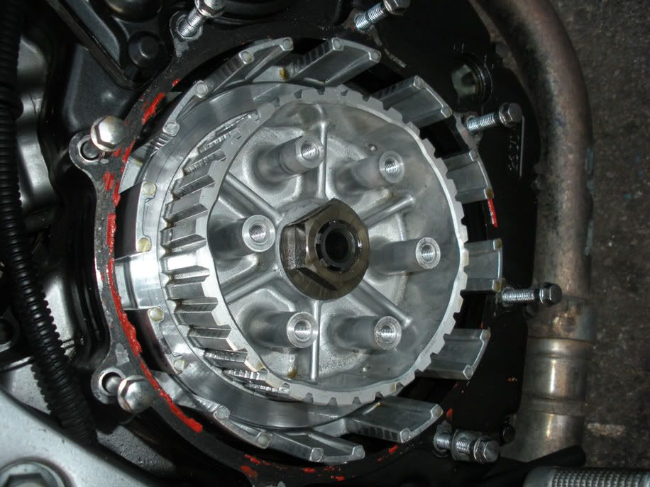

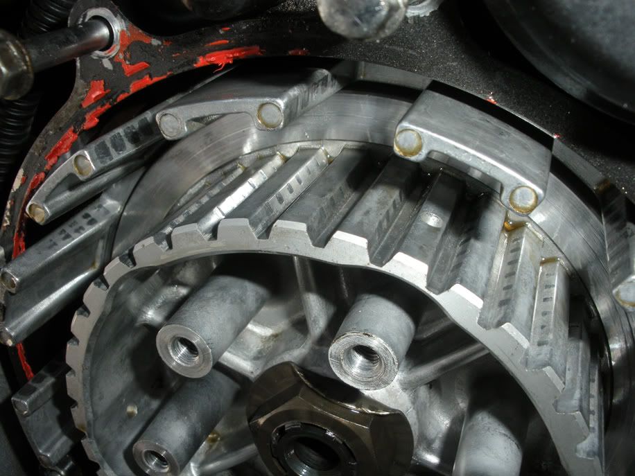

Alll the occurences of these symptoms I have found is a notched or worn basket. The clutch actuator moves as it should even when adjusted correctly but the plates in the clucth do not separate with the engine running due to them not being free to move along the splines of the clutch hub or being held by notches in the basket. This gives enough drag to prevent clean selection of neutral. It is simple to check, lean the bike over to the left or drain your oil, remove your clutch cover the basket can be seen and any wear. to check the splined hub simply remove th end cover ad springs then the clutch plates, keeping them in order!! and the hub can be seen.
Any small notches can be removed by light emery paper it is amazing how a small wear groove can prevent smooth operation of the clutch.

Clutch plates look a bit grim, like they've overheated at some stage, but good oil supply.
Basket has tiny markings, you'd accept it as a used condition basket. I've ridden worse with no problem.
Because my problem only occures when the bike warms up, it points to the plates I reckon.
Basket clean up and new plates? Just new plates? I reckon its a good two hours of careful work with the basket, had not Gix suggested this I'd never say such minor markings could cause the problem...

Yep my sons basket only had small marks but it was enough to cause the drag you say you re experiencing especially when warm. It will trash your plates as it never really clears when you are sat in gear with the clutch fully in even when adjusted correctly as the plates cannot seperate. Like you say careful work to polish out the marks is how we got round it. the same bike is road retired and is now thrashed as a track bike with the same clutch and basket and she is fine.
