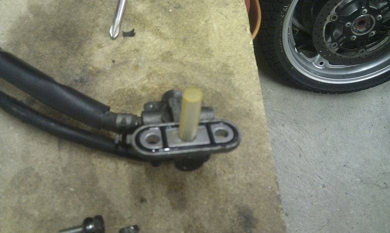

Did you use the choke lever?
If so, did the choke fully close when you returned it?
You DID return it, didn't you?
I used it first thing in the morning when the bike was cold. Yea it was returned but somebody at work mentioned that it may be worth investigating that its functioning properly. Gonna get the tank up tomorrow and start by having a clean of the filter and go through from there. Hope its nothing to serious.

3) The fuel filter was clean, we tested the petcock off the bike using a syringe to open the vacuum valve and fuel flowed freely out of the tank.

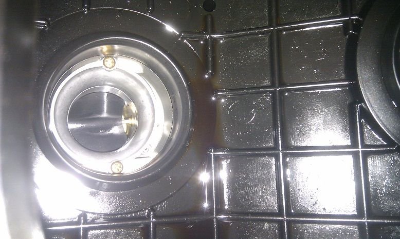

A loose plug won't fire correctly, carbon builds up on the gasket face and stops it connecting to the engine case completely.
do we need to go back and remove the carbon build up somehow?

Should have shown this too, its the front spark hole:
Unlikely, unless it's been doing it for a very long time, the action of screwing the plug in will have wiped it away and now there will be metal to metal contact. Won't hurt to pull the plugs and clean them anyway, the plug condition might provide some info too.
