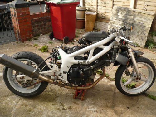

i think i need to post a picture of the bike so you will get the idea of what im dealing with, the top yoke is gone so the bars are just hanging and at the time it didnt come to my mind that they would pull which i should have really paid attention to. i tried a battery from my virago 750 and that spins nicely on the virago, plus its 16amp so a bit stronger that the sv battery, did one mesurment now with this battery and same thing happends, its not fully charged at the moment so i didnt expect anything so im gonna leave it overnight to charge. but when i pressed the starter button the voltage on the battery dropped from 12v to 1.85 which is a massive drop. so im trying to figure out why is that, is the starter motor foulty? or the engine seazed up slightly? but running high at high rpm for 5 sec i wouldnt think anything major would have happen

sebamax2
Default Re: Did my engine seize up?
[IMG][/IMG]
thats so you can see what im dealing with
