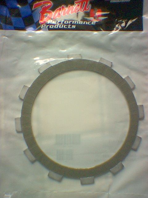

Just to let everyone know, a full Barnett clutch kit (friction plates, steel plates, springs) from PDQ for £115. They are official distributers of them in the UK.
Not bad considering that it is ment to be better than suzuki OEM, the cost is very similer or more. I calculated it to be around £120 for the lot OEM.

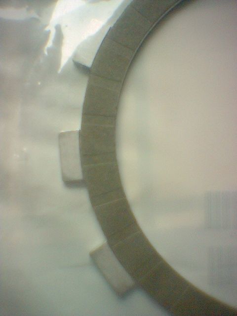

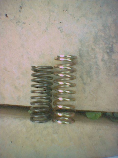

These are pics of the new plates and also a pic of the old sping vs. the new one.
Friction Pads
Old spring vs. New Spring
