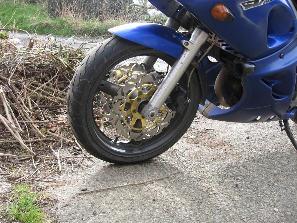

Where are the discs from Jayne? The rotors are an identical pattern to the Chinese discs I have on my curvy.
How have your disks lasted? I have no idea what these disks are, but I am a bit worried that they may be Chinese cheapies and could break while I brake!
The disk carrier is an aluminium alloy that has been painted rather than anodised and the bobbins that hold the rotors on to the carrier are very shiny stainless on the main part with a nasty rusty steel washer on the back. However, these backing washers have been sanded and then painted to prevent them from rusting again.
The brake calliper has also been adjusted for fit and the rotor now runs dead true in the centre of the calliper. It was out by just over one millimetre, but it was enough to annoy me and to rub on the disk rotor.

The discs are superb Jayne. The anodising is still as good as when they were fitted more than 7000 miles ago (I'd have to do some checking for the exact mileage), no blueing, warping, cracking to the rotors. They really are very good quality.

Jayne, when you painted the wheel did you mask off the disc mating surface where the bolts go?
if not then take the discs back off and take the paint off carefully back down to the metal trying not to take any material apart from the paint off.
There is nothing but bare polished metal under them there disks Sir, I thought that you knew me better than that!
This is a good point though folks, paint under there can make for an uneven attachment of the disks and although I did not mention it, I did make sure that the area was clear of paint before attaching the disks.
