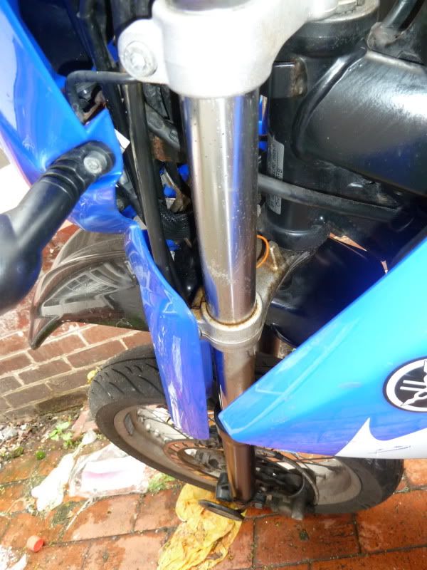

thanks for the info, rarther scared to break off all the rust on the exaust, did remove some and it does seem solid underneath.
ive gone over the forks with wd40 and this is how they ended up
thost little bits i cannot seem to scrub off. is that pitting? would wirewool do the trick, i only used a scoured sponge?
the subframe, couldnt get anything off, what paint would be best just to go over with to cover it?
and another thing, the underneath cover, can that be painted too?
thanks for everything again
EDIT - seems you cant really see the little bits on the forks in the pictures. you can assume what they are like in person i guess.
Yes it's pitting, you can't remove that.

With the pitting on the forks get some araldite on the lower part and fill all the little pits allow to dry and with a new or nice and Sharp fine metal file just lightly file of the excess alraldite the file will not scratch the fork tubes don't worry will stop the fork seal getting trashed I did this on my dads xr400 seemed to work quite well

the little bits i mention, arnt holes in the forks, its like specs of rust that need scraping off, i tried with a knife...and managed scratch some off but to no avail completly.
Sorry if this is a mess on my phone
Yeah, bit bodgy, but don't use a file, just wet and dry is good for that.
I know it might sound dodgy but its the best for the job as Its very precise wet as dry will still leve fine scratches the file leaves no marks aslong as its used correctly
