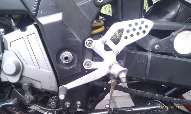

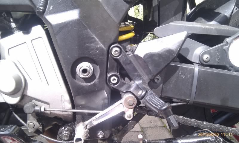

Stock rearsets
GSXR k3,4,5 600/750 rearsets
Gear linkage rod needs to be 10-15mm longer than stock GSXR I think?
RHS
I've sat the GSXR ones on top of the stock and the mounting holes are lined up.
