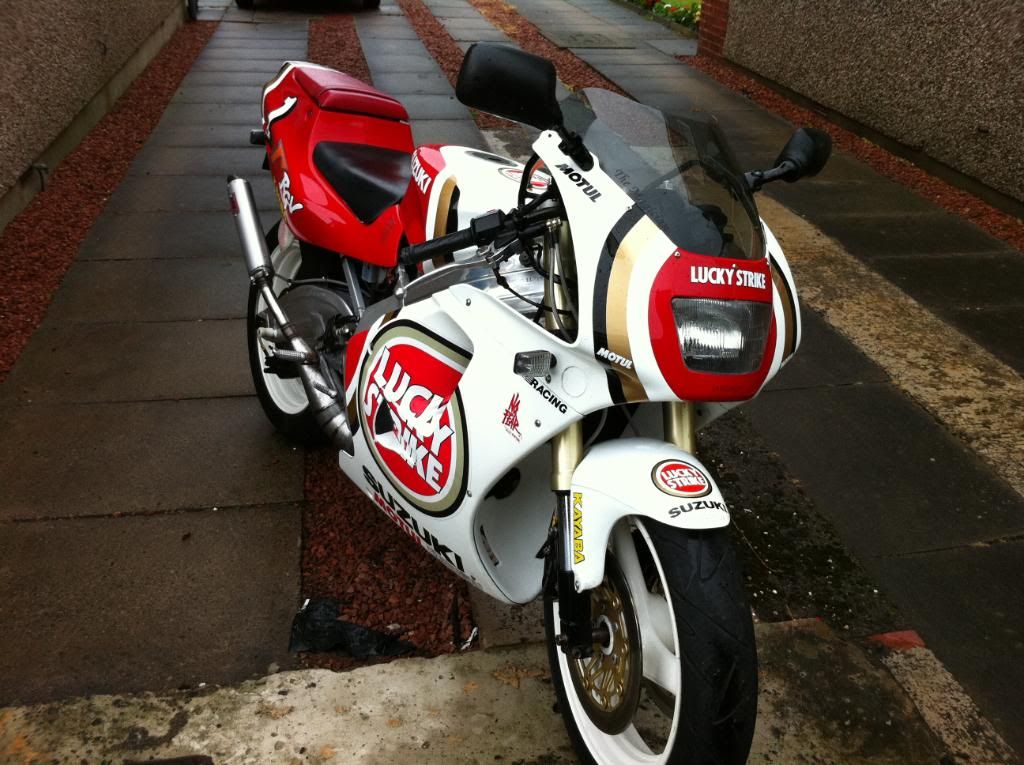

Oops. That was the plan for tonight but I seem to have taken it apart instead.
I was making a list of bits and pieces that needed doing and before I knew what was happening I was up to my elbows in it.
I didn't want to get into that right now so I'll put it back together and do a basic service for now. More pics for the weekend so you can see all the bad bits.
On the bright side, the frame looks sound and the engine's clean. There was a wee spot of oil on the floor under the sprocket cover but the chain is very wet (lubed with engine oil) so I'm hoping that's all it is.

I tracked the oil leak down. Once I got under the bike with the fairings off I could see the oil has been dripping on to the exhaust and then running off the lowest point. It's coming from the exhaust at both cylinders.
Neither of the leaks is serious so nothing much to worry about. Both headers are missing a spring each so that was something else for the list.
More pics;
The wheels and discs have been tarted up recently. Calipers and forks look good too.
No rust to speak of. There's a wee bit on the rear subframe - just surface stuff. Wire brush and Hammerite will sort that.
There's a bit of wear on the fairings but nothing major. Unfortunately the Lucky Strike decals on the lowers have been thrown on from a distance.

Nice!
That looks like heat damage Tam
Replacements aren't hard to find! Found JPS replica stickers for a GSXR 400 in a hour.
I would get a set of custom reps made by PT6 someone similar

Tam,
The oil leak is common with Tyga's if you don't fit a new suzuki OEM crush washer. They don't come with the kit on the tyga's so most people done bother. Without them they will leak oil. I got a set of brand new ones on my Tyga's and mine don't leak at all.
