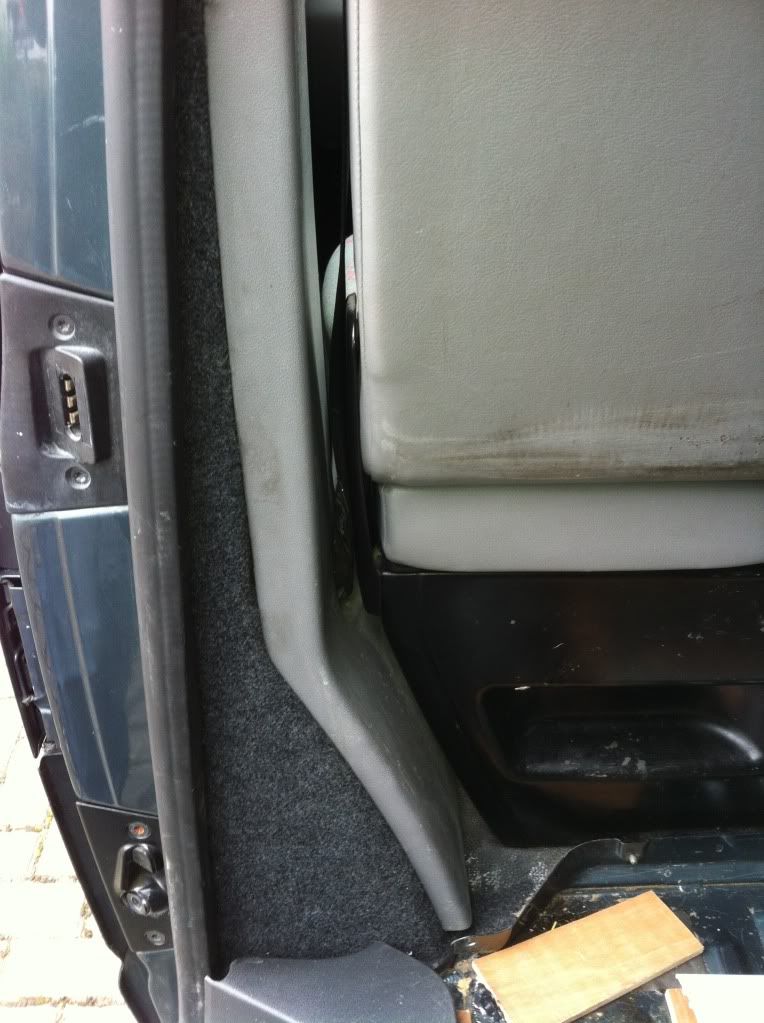

The last two weeks I've been trying to find time, inbetween helping out with the baby at home, to work on templating, cutting and carpetting ply. Most were fine as I had the original hardboard templates but the rear full height panels I had to template. What a disaster! Long story short they only just fit (badly) when bar but when carpet went on it was too difficult and it didn't achieve the perfection I want.
So I ripped them out and called a lovely chap at AJC in Stalybridge who before starting work on a booked in project managed to bash 2 full height rear panels with the holes in the right place and supply advice and blind fixings for me to do my ceiling panels too!!
So carpeted those and got them up, didn't take any pictures but there are some to follow which will show them.

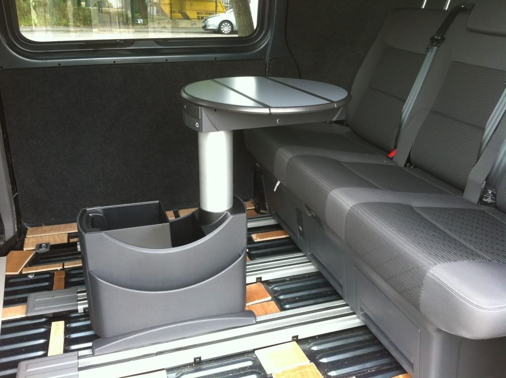

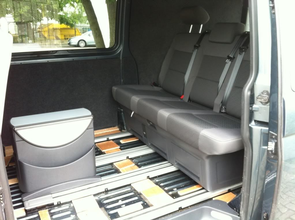

I was originally toying with the idea of getting a triple shuttle seat and putting brackets in the 2nd row and 3rd row so I could move them around. In the end though after a quick call to Colin at Oxford T5 I bit the bullet and booked in to get Caravelle rails and a triple fitted...and I'm so so glad I did!!
I waited at the unit whilst they were being fitted as I was interested to see how it was done and had nowhere else to be. Apart from a lovely Sainsbury cafe breakfast!! Mmm it was ace!! The only downside was that I had a table and the 2 single seat staring at me all day!! I resisted the single seats (just) but had to grab a table!!

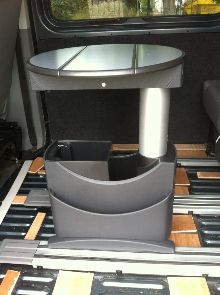

End result:
Table is genius!!
The seats can slide all the way forward, all the way backward and be completely removed.
It also folds out to be a bed.

I also started carpeting the metal work starting passenger side. Went ok but I think I'm going to bottle it and get a pro to do it.

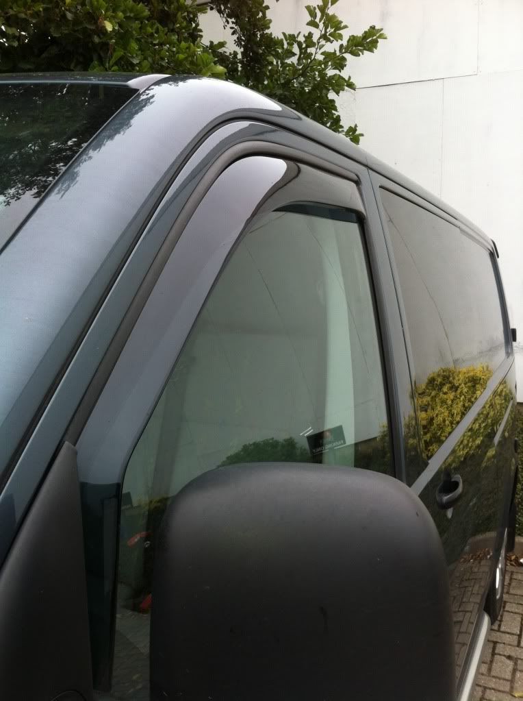

I also bought some wind deflectors, went on ok although the drivers side seems to be a bit weird and my automatic window mechanism doesn't like it and stops half way up.

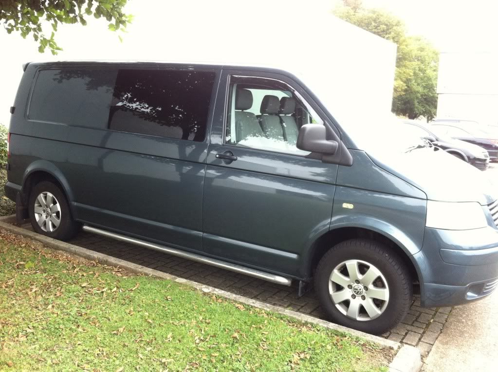

And the whole van:

Re the window I think if you just move it bit by bit till it reaches the top you then hold the switch in the up position for about 3 or 4 seconds and that reset the anti finger trap so it can close as normal
