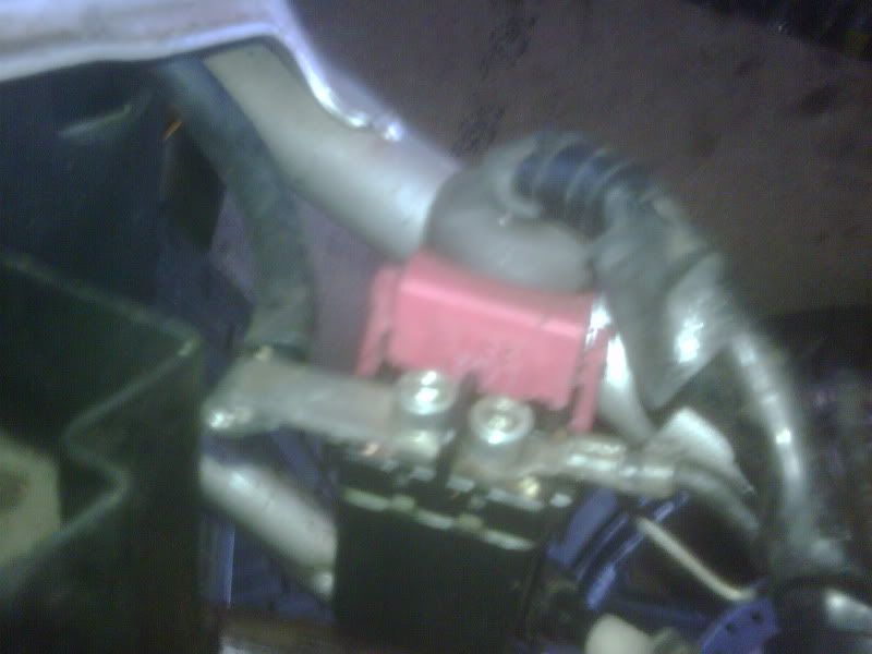

Right, last night, didn't get as far as the calipers, well I did get one off and the fluid out but nothing done with it as I couldn't get the pads out, till I noticed how they were held down. Now gotta get the caliper back on the bike and hope i can get the retaining cap and pin out (you gotta love Honda).
Ady come round, so I stopped that as hammers got involved and there were more important things to do. I took the carbs back off, routed the throttle cable, destroyed a rubbber carb clamp thingy but managed to repair it okay we think, will soon see. and got everything back in place and screwed on properly. Then after he went, got the downpipes on after some work, but by eck it was a task. Looked at all the wiring and thought, there is no reason this can't turn over now, but a flat battery. Starter button and nothing, okay we'll charge the battery.

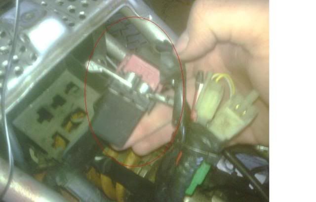

Got to it this morning to see if she would turn over, after working out the actual configuration on how to start it..................................she ticked...and that was it, for as long as I held the starter button in...The ticking is coming from here
And a video of the tick, as long as I hold in the starter it will do that. I'm thinking maybe I have wired the starter motor up wrong...

Sounds like a dodgy solenoid or that the battery is knackered. Get some jump leads across to a car battery, leave the car engine off and give it a go.
If you get the same noise, turn the igniton on and short the solenoid with a spanner, should spin the starter motor without you needing to press the start button.

When you say the solenoid, is that the bit in the piccie?
Short the two connectors on that you mean?
Old 18-06-09, 09:12 AM   #40
flymo
flymo's Avatar
Join Date: Jan 2008
Location: North West
Posts: 3,124
Default Re: Project - Snail
Yep, the thing that is ticking. There should be a thick black lead from the battery to the solenoid, then onwards to the positive terminal on the starter motor.
When you press the start button the solenoid acts as a relay and allows the high current to pass to the starter motor. If you make sure the ignition is switched on, shorting across those two big terminals on the solenoid should spin up the starter motor as if you had pressed the start button.
If the starter spins with your spanner 'key' then you likely have a dodgy solenoid or connection to it.
To test the starter itself just pass a jump lead from the positive battery terminal directly to the positive (there's probably only one as the case would be the earth) terminal on the starter. If its good and you have juice in the battery it will spin.
