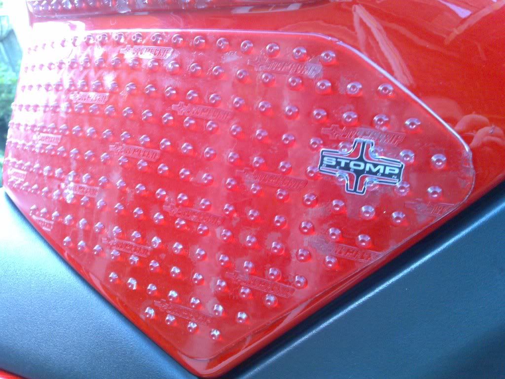

I found that the angle of the seat on the Daytona pushes you forward all the time so I decided to give the clear ones a go.
They really do work and I would have them on any of my future bikes (even thinking of fitting them to the KTM).
Braking is less harsh on the arms and fatigue is reduced too.
Hard braking no longer crushes my balls into the tank either
Treat them like a motocross graphic and get them really hot defore you stick them in place.
I held mine ofer the gas hob till I could hardly touch them, lined them up and stuck them on.
If you heat them, it makes them more pliable and you get less air pockets.
I then left them 24 hours before I rode the bike.
Someone at Soho one night commented on how good they looked with no air under them!
Once the grip is put in place and is still warm, run your finger (or a pencil) between the knobblie bits to push out the air.
Heres mine just fitted and before the air was pushed out.
I'll take more pics if anyone needs them.
I've done 2000 miles with mine fitted now and have had no lifting/peeling as yet and still have no air bubbles underneath
**The lines you can see in the pics are the reflection from the french doors**
