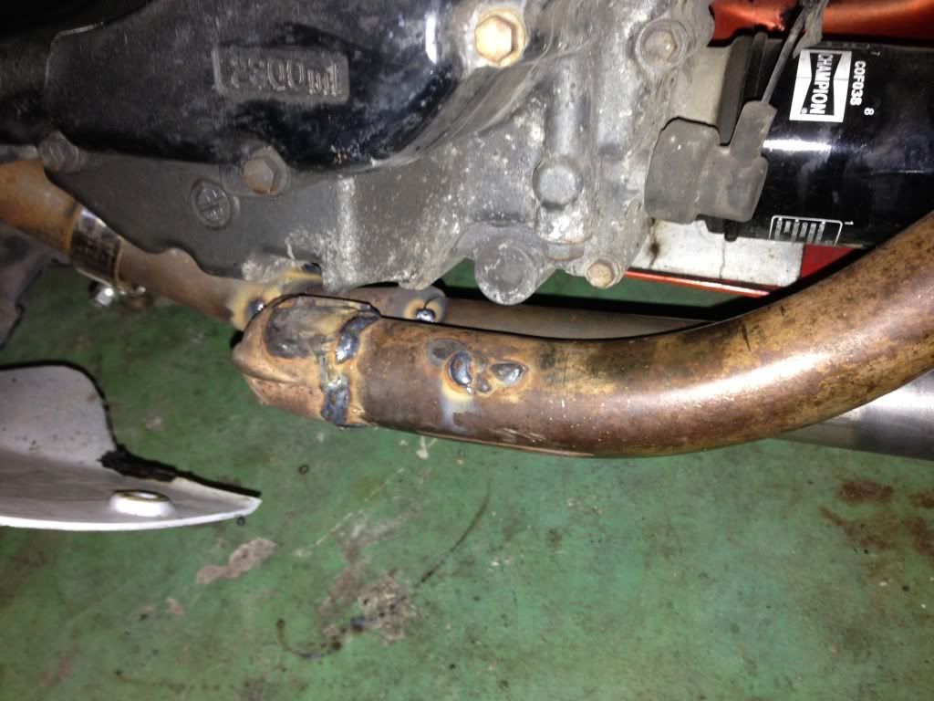

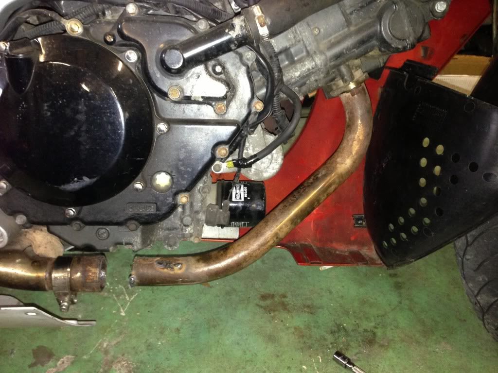

First remove the right side fairing, I've left the other side on as I need reference for the space I have for the turbine exhaust which is the current dilemma as stated.

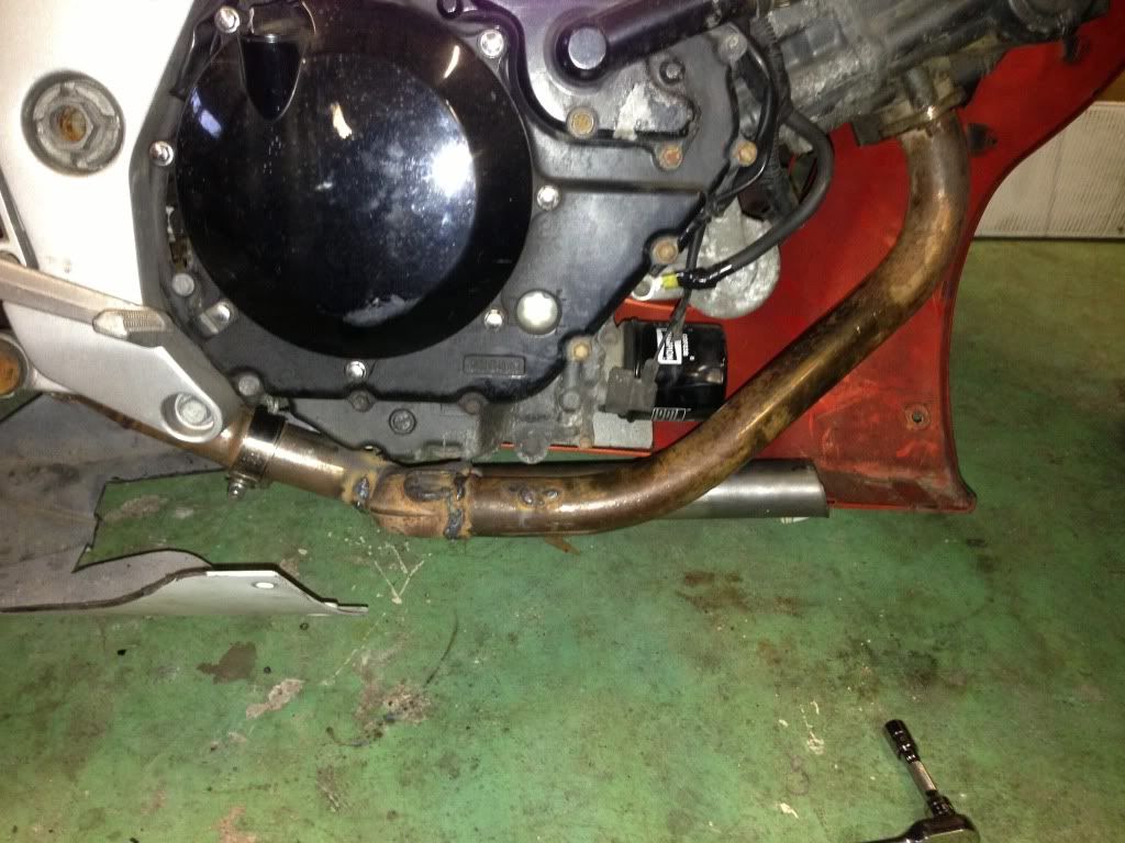

Next chop up exhaust!! Yes I did say chop up your exhaust you did read right!!
Next cut and trim tiny the awesome U bend already available in the exhaust, what a win!!!!
Next, run the exhaust as close to the body as possibly and weld in said U bend!!
Yup that's as far as I got before I had to come in and pee so give me an hour or so for the next update lol

We need to keep the pipes equal length so we can cut down on backing up the pipes so using the U bend supplied by Suzuki we can turn the front cylinder exhaust round and feed it in with the pulses from the rear no problem as so...
Once matched and clamped up we can extend that line from the rear back forward giving us the turbo exhaust feed again as so...

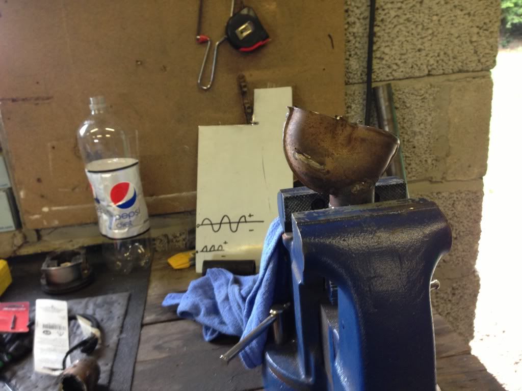

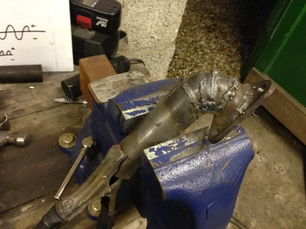

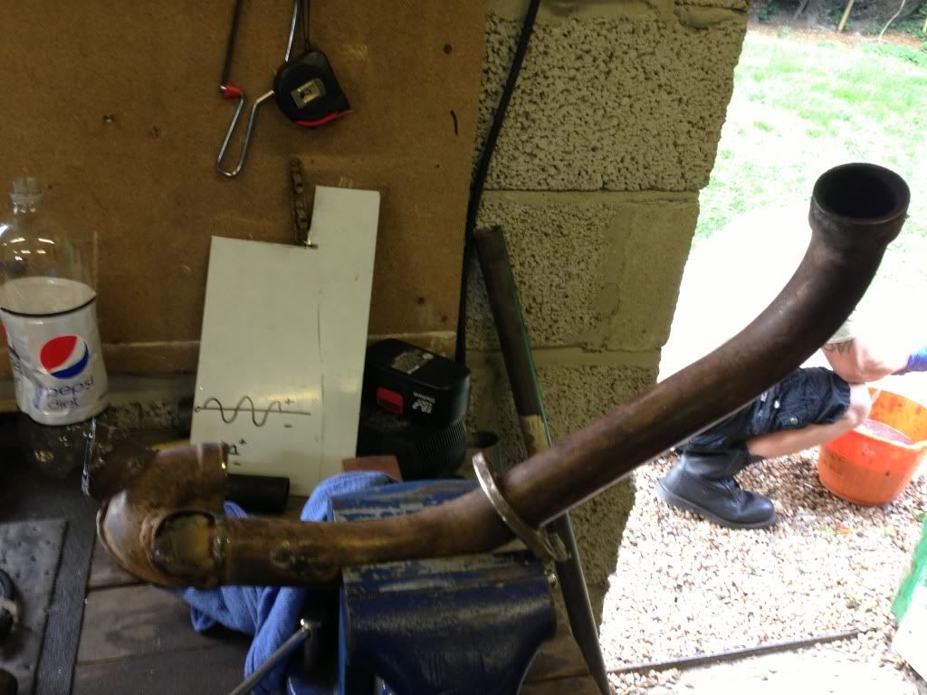

Time to fashion a flange for the turbo and weld said pipe to it...... This flange is as per turbo as they all have different foot prints.
Next cut lots of angles cos your too cheap to but in bends from guess works and the shops are shut!!!
Weld it up once correct whilst pretending you're not almost out of gas.....
Now to relax and eat a kebab wrap and chips ***think big smiley face when this turned up for dinner!!!***

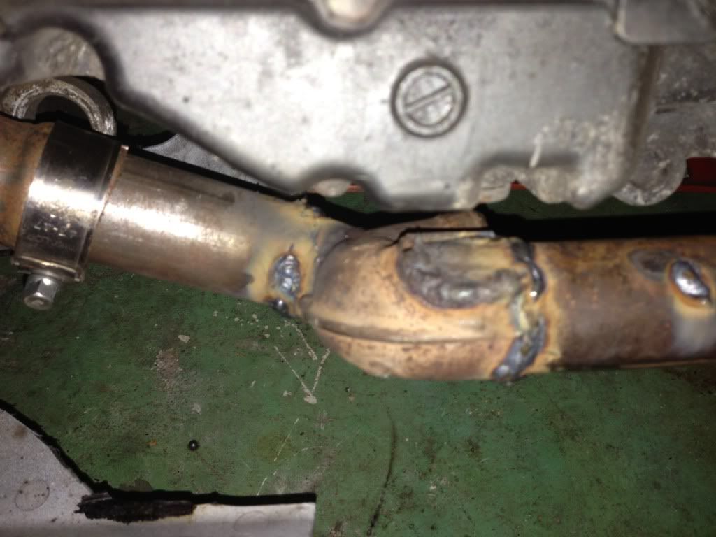

Now weld it to the front facing exhaust feed and notice that is way to an aggressive angle and that you'll have to change it tomorrow D'oh!!!!

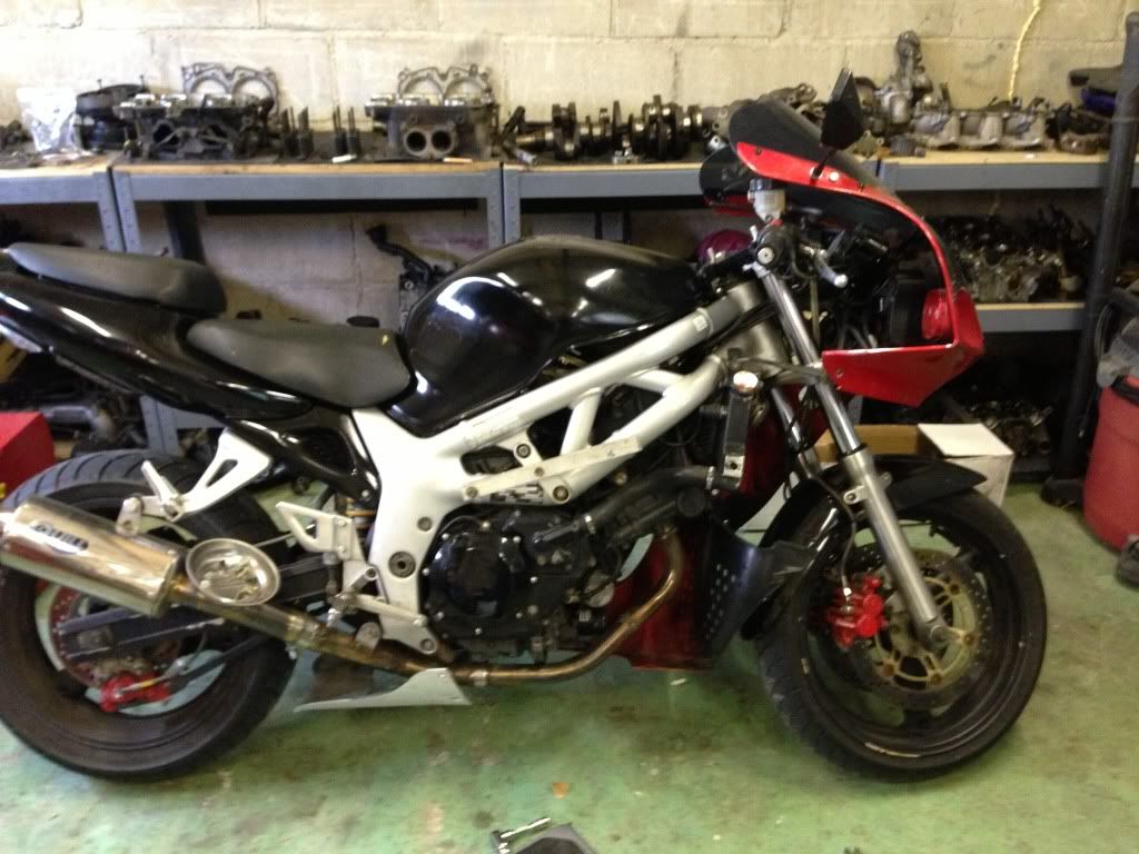

Fairing fits though......
