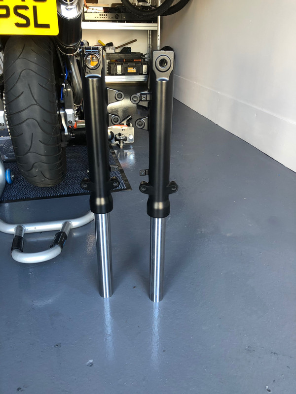

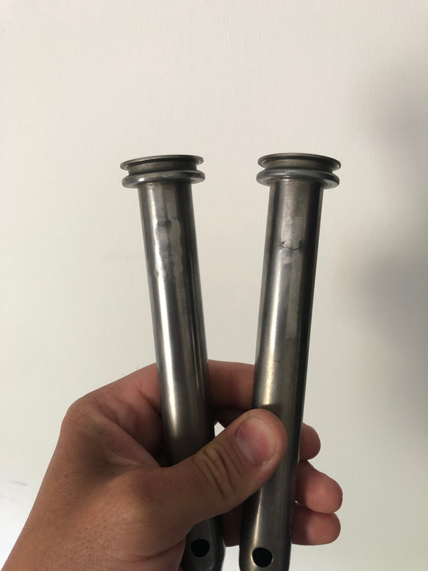

It’s fine. I will use masking tape to protect fork. Should have mentioned I want to paint the bottom fork. Got the damper rods out and now soaking in degrease.
Old 26-04-20, 04:27 PM   #32
pedro3178
Default Re: Advice on front fork springs
Happy with how these turned out
This was the colour of old fork fluid

Cheers guys.
Managed to get the damper rods welded up

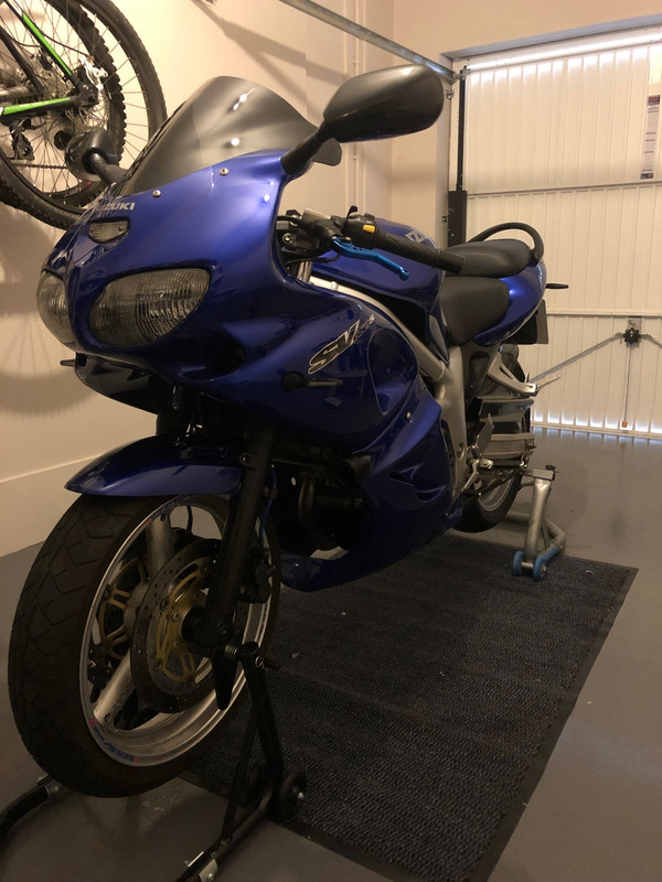

That's her back together. Obviously I can't road test just now but even the basic push down rebound is night and day to what it was. Can't wait to give her a try.
Big thanks to everyone for their input and help. In the end I went for proper weld on the rebound holes, 8.5 progressive springs and Silkolene RSF 7.5 oil.

now for some suspension wisdom.
to check that everything has gone well and things are correct.
take the bike off the stands and push down on the front end as hard as you can and let it pop back up. you want the dampening to let the pop come up and stop at rest or just a slight 3-5mm overshoot ten down again. there should be no pogo effect.
weld done
Old 29-04-20, 07:56 PM   #40
pedro3178
weld done
Just tried this out. 100% no pogo effect now
