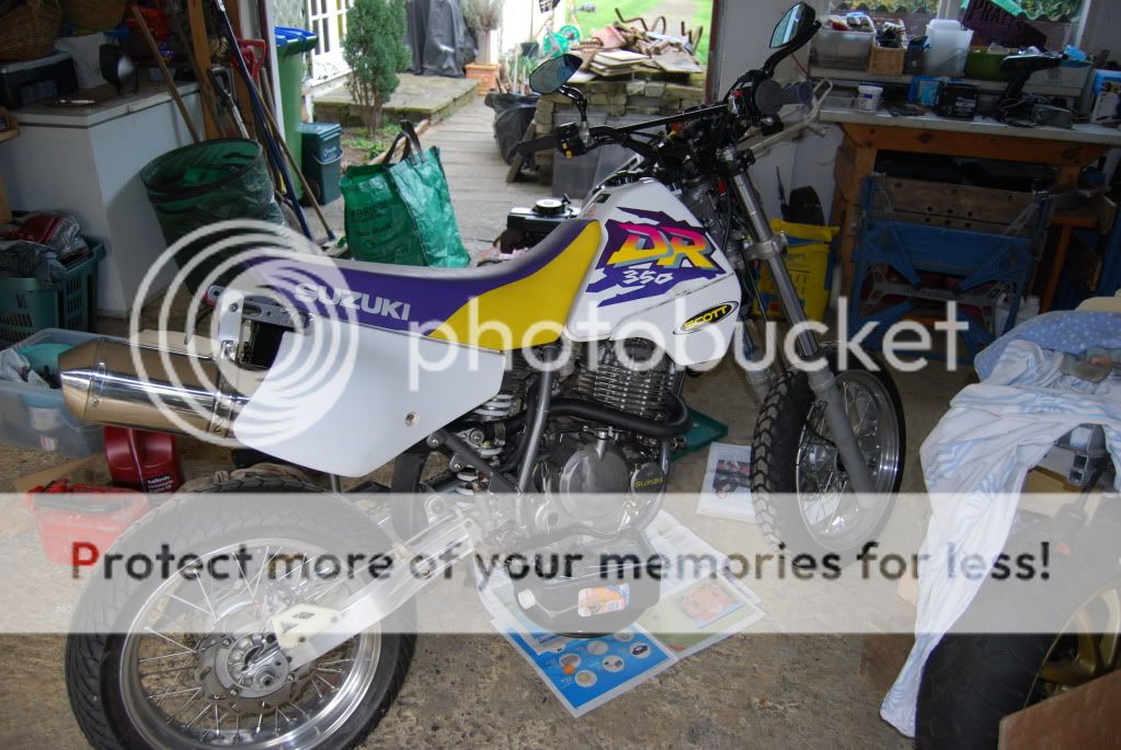

dun dun dunnnn as promised to you lot.
Got it running today so im bloody happy.
Few issues which is why theres a drip pan underneath but thats the internal diameter of the oil piper so it leaks £10 for new lines to sort then i can start on the suspension rebuild and general spraying up of bits.
one beautiful motorcycle.
Side panels scrub up quite nicely after a light polish with a drill.
shiny stuff and a well soaked chain that is now free of all stiff links and good as new!
nice and clean, actually bits look better than new after being blasted and sprayed.
nice rear brake which has the same treatment and braided line.
Now for the exhaust. £90 off ebay and it sounds amazing even with the baffle in.
Also header and link piped sprayed with exhaust paint but bits bubbled so may need redoing, you can see small specks near the front its a pain
notice the nice home made brackets aswell for the link pipe and hanger and nice new clamps

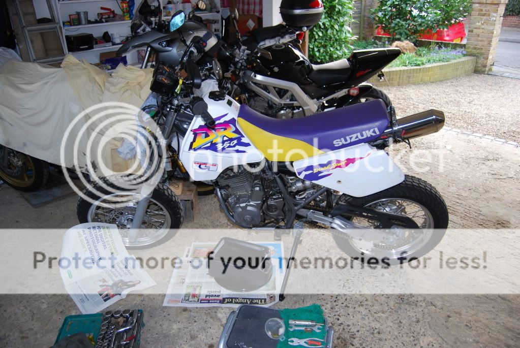

after a few months chocked up on its stand ive spent the last 2 days running around getting it all sorted.

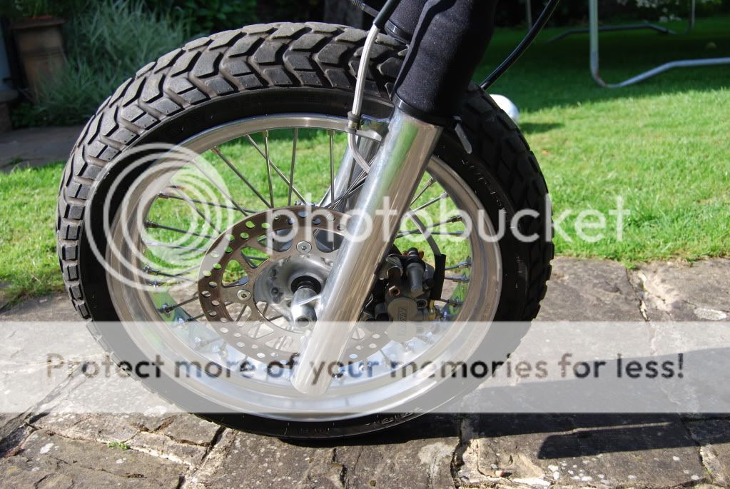

Shiny shiny forks and nicely balanced up wheel, not to hard once you get the hang of it so i think its all straight and true. Also some nice fork socks to keep it all clean underneather.
New seals and bushes all round with hangon springs aswell.
brake fitted with braided line, blasted and sprayed calliper just need shiny bolts next.
No headlight because someone who i wont name put the brackets on the wrong side
No side panels either as they need some good polishing to make them shine like new.
Im in love with the rear fender and tail unit as the brake light being LED and clear is blindingly bright.
New gear change to
Forks are going to get dropped through a bit more soon.
Engine casing off tomorrow hopefully for a strip down and spray up over the week and a 1 of the oil hoses needs replacing.
whilst im in there have new thrust washer on the way so i can do the basket clearance and create end shake. makes it smoother and stops the wear on the washers and bearing.
not far off at all and it runs like a gem atm just waiting for the new throttle tube to turn up then handguards and grips can go on to

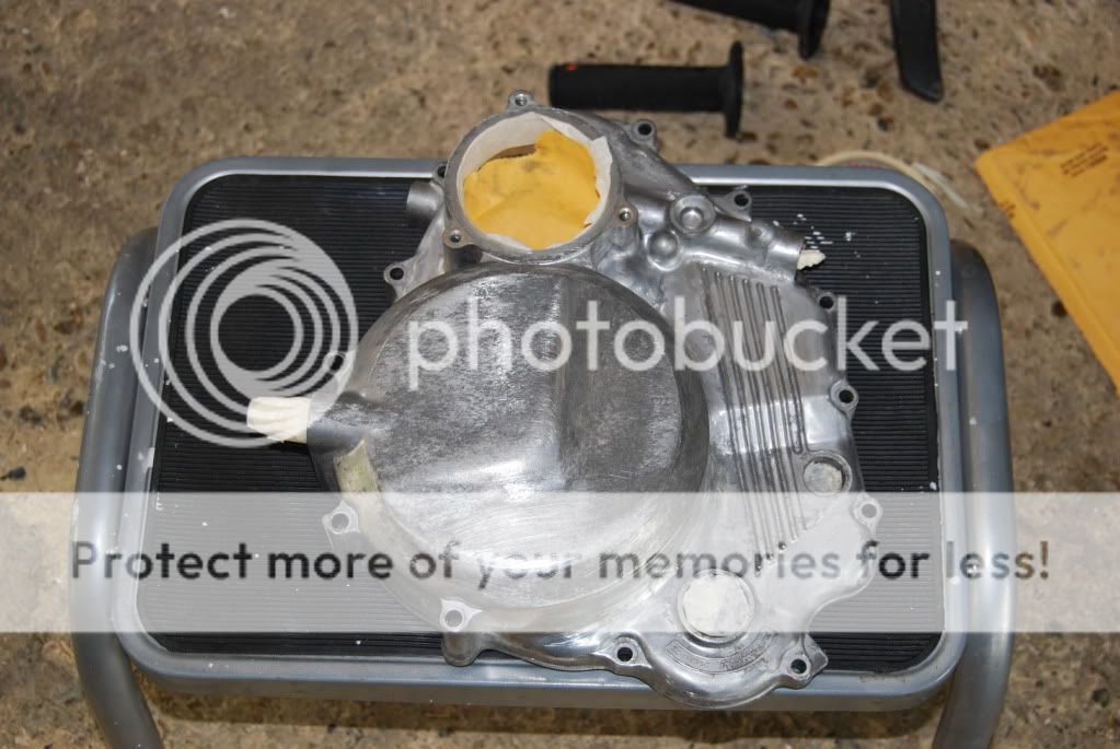

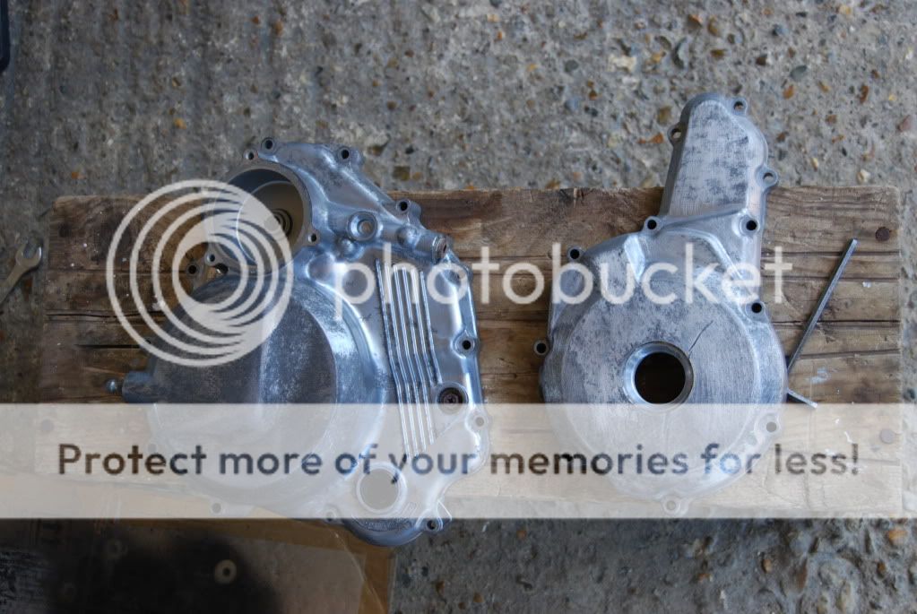

Todays efforts are brought to you by paint stripper and how its removed suzuki engine paint quicker than my skin....yes its that thin and bad.

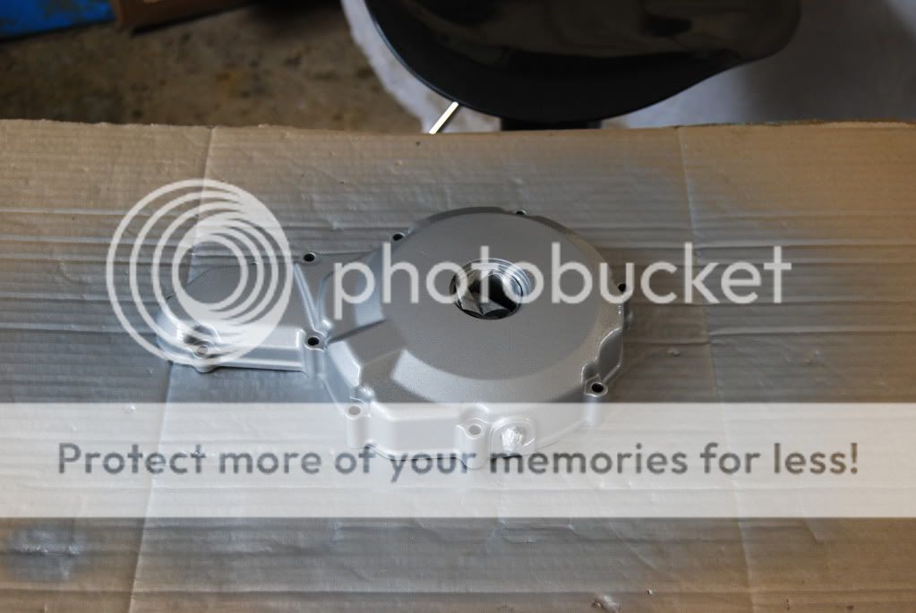

casings off and prepped for a painting.
1st coat to final coat, think its come up quite nice if a little lighter that i wanted.

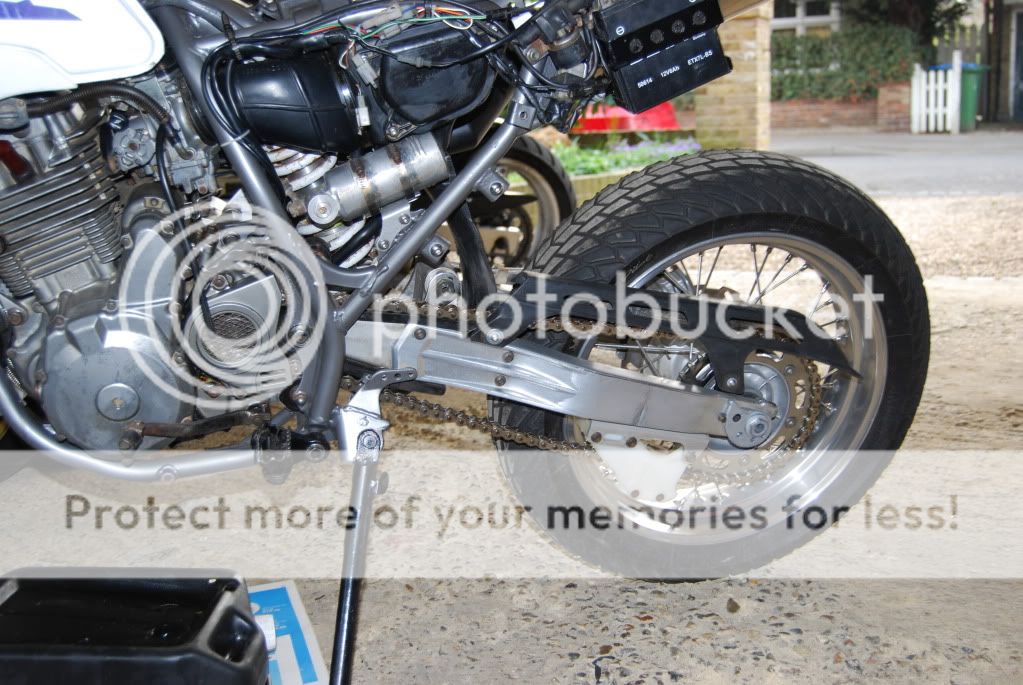

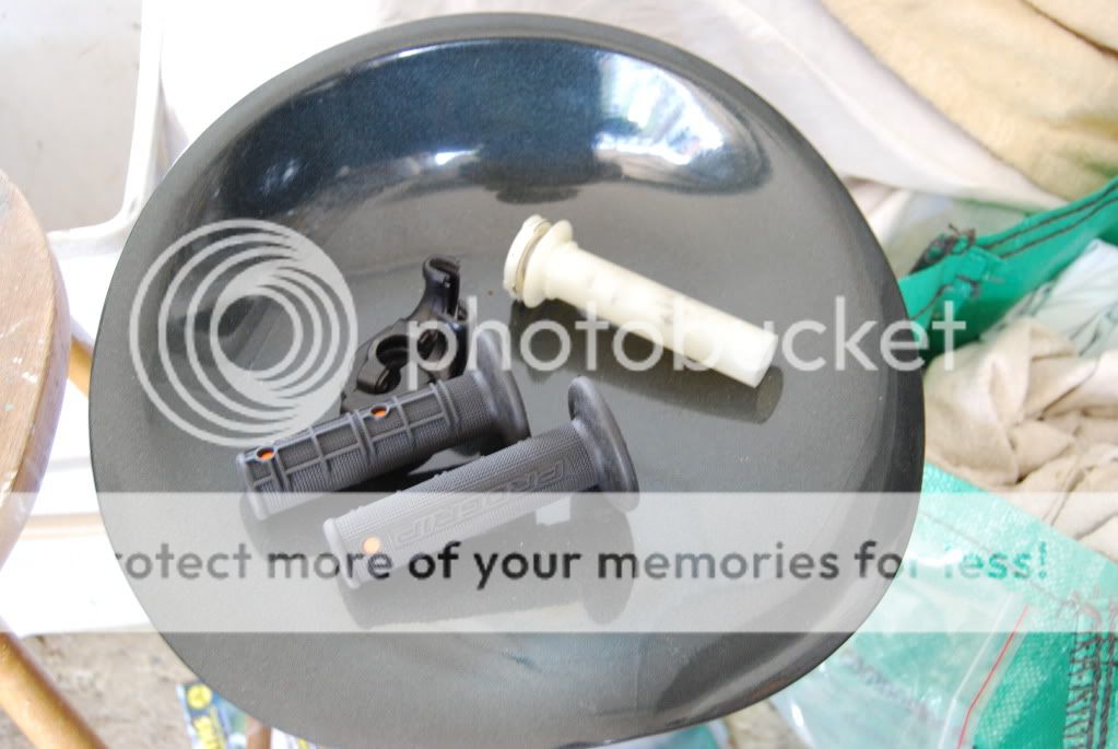

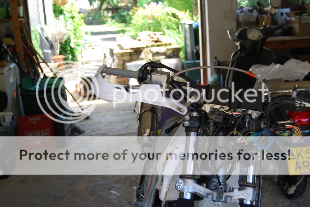

new throttle tube arrived which has a open end and allows me to fit hand guards. just a quick fit but you get the jist of how its going to look.
Tomorrow it should all go back together if i have enough time, new clutch cable can go in then a little test ride around the garden might even wack out the rear plastics as it will look finished and give me some inspiration to get a move on.
