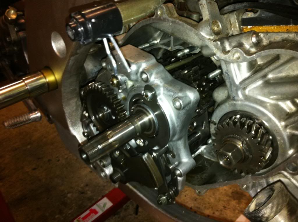

As I've said, the bike was slipping out of 2nd gear under load so I've pulled the gearbox to check it out. It's a known problem with the RGV - usually caused by excessive wear on the dogs where 2nd and 6th mesh together.
I've never removed a gearbox before and I think this was a good one to start with. It's a cassette style box so no need to remove the engine.
Clutch cover off, remove the 6 bolts and springs then slide the clutch pack out.

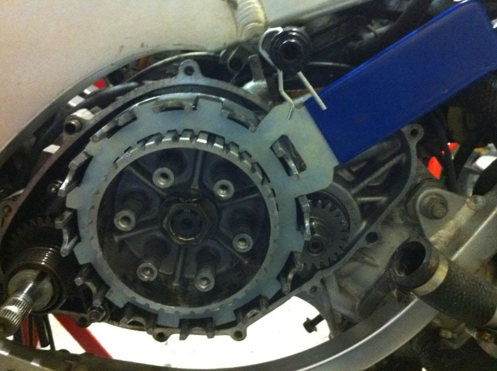

Break out the special tool - clutch holder from ebay - so I can get the centre nut off.

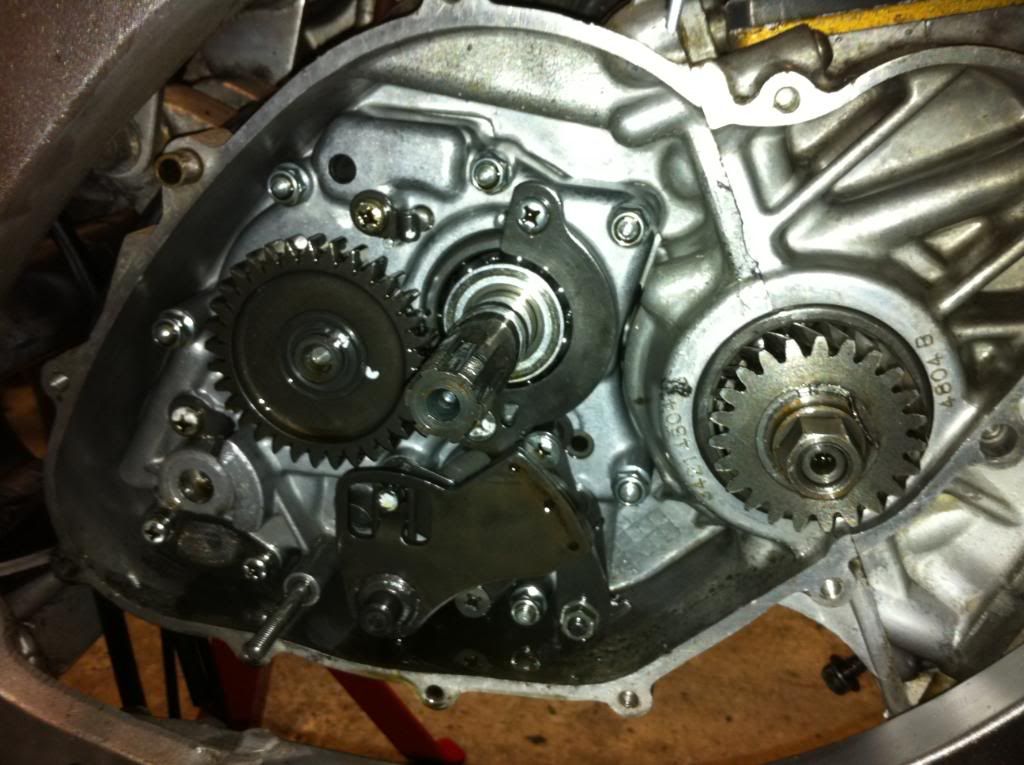

Clutch basket out and kickstart mechanism removed, then undo the 6 nuts around the gearbox case.
Quick tap on the sprocket drive from the other side with a rubber mallet (after removing the sprocket and circlips) and the box slides out.
There's a bit more to it than that, but not much. Pretty straightforward.

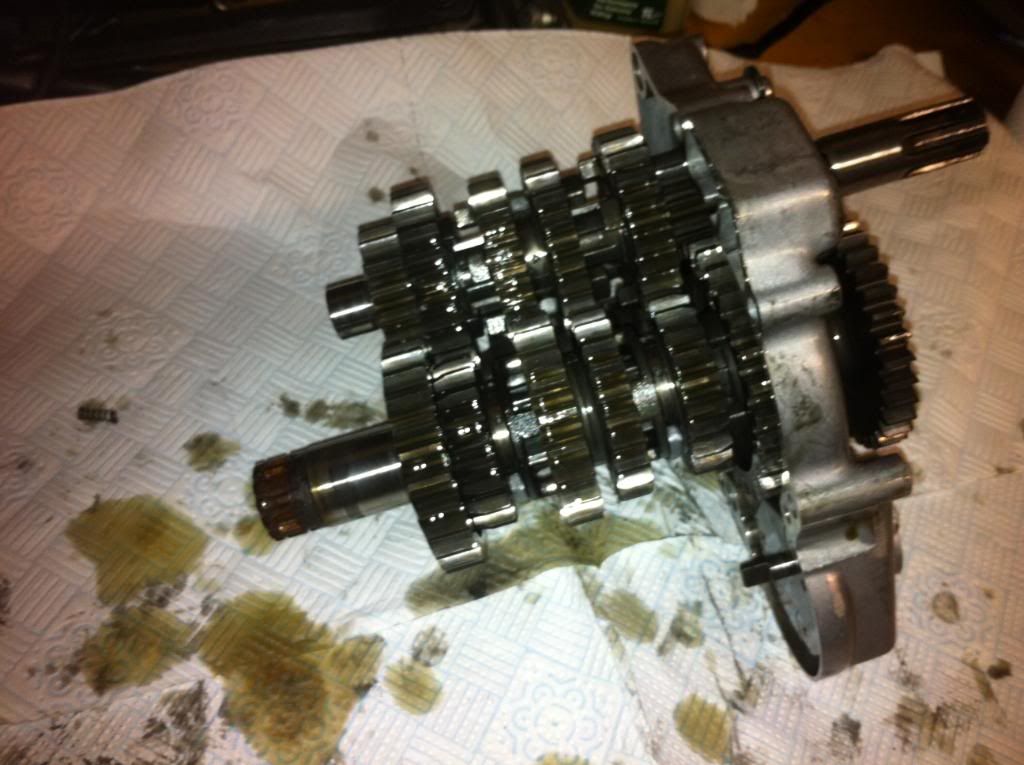

One gearbox on the bench.
If at this point, if you don't spend some time twiddling the gears and snicking up and down through the box then you're just weird.
After dismantling the gears, and keeping the worlds supply of washers and circlips in the right order, I can start inspecting for excessive wear.
Sometimes it's hard to judge what is too much wear. Sometimes it isn't.
This is "too much".
I need new 2nd and 6th driven gears plus a selector fork which was worn beyond spec. That should be it sorted.
