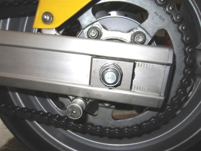

If it's of any use, I made a pair for my curvey because the std items are so flexible. I used 5mm stainless, but because the wheel spindle doesn't have a lot of spare length I counterbores them a little (1.5mm or so) to recess the head and nut into them. This actually looks better and I used a thin s/s washer under the nut which can be sacrificial to some extent, I'll replace it if/when it gets scrawped (technical term!).
The bores are different (hence the markings), the brake side goes on the plain part of the spindle. 17mm I think, while the chain side is on the thread, 16mm. I made them a "decent" fit (you know what I mean).

that's a nice job embee.
i take it the 5mm is the recess hight from the bottom of the trough to the top edge before it falls away on the angle?
