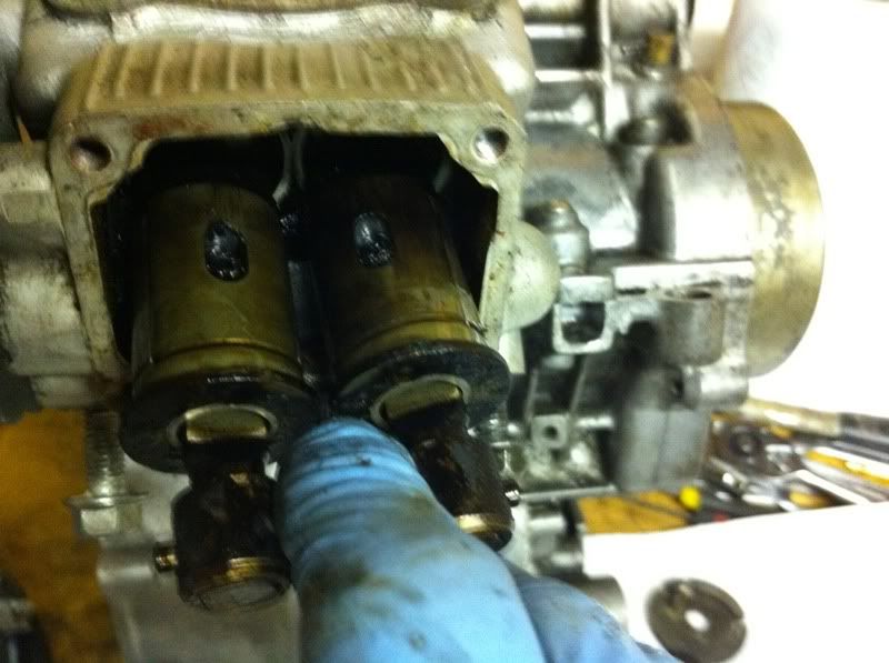

I've taken the cylinder heads off and then decided to tackle the Powervalves.
The retaining screws are put in with permanent threadlock. Worse, they're standard Suzuki crosshead screws of cheese - adds up to a recipe for disaster. I got all three out no problem on the first cylinder with a wee bit of heat and an impact driver.
Getting a bit cocky, I started on the first screw on the second cylinder. Thought I'd got an 1/8th of a turn with the impact driver so carried on without taking a look. You guessed it - totally mullared the head of the screw.
No panic - I'd half expected this. I took out the pulley shaft and lifter to make a bit more room and then broke out the drill and left handed bit.
By the time I'd drilled nearly half-way through the bolt without it biting I was getting nervous. The powervalve housing is a cast part of the barrel so getting that screw out without damaging the threads was my only option.
Had a go at the other 2 screws with the impact driver and got them out no problem.
Lots of black gold in there - and that's the cleaner of the two.
In a rare moment of clear thinking I decided to try tapping an allen bit into the hole I'd drilled. I had to use a screwdriver bit as there was no clearance for the allen socket I wanted to use. I've got a wee adapter for the screwdriver bits that I can get a 10mm spanner onto.
Worked a bloody treat. Screw came straight out and I could then withdraw the powervalves ( had to give them a tickle with a finger up the exhaust port to loosen them off - this seemed very wrong somehow).

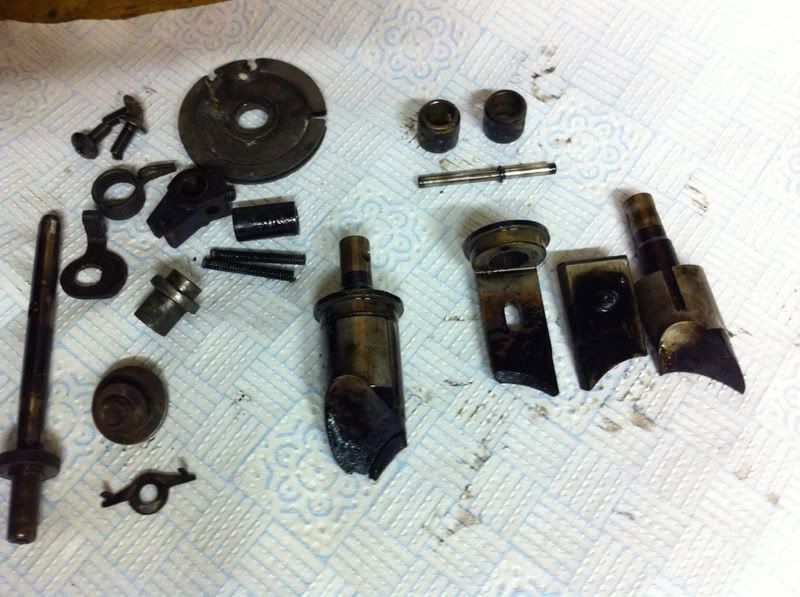

This is the various bits from one cylinder's power valves, with associated baked on carbon deposits.
And one pair of valves cleaned up.
