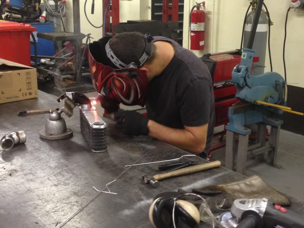

Ok so I'm sitting at work about to take my lunchtime nap whilst my intercooler is being welded up!!! ***Thanks Dave*** I have no idea how to TIG ally so again whoop whoop for Dave!!

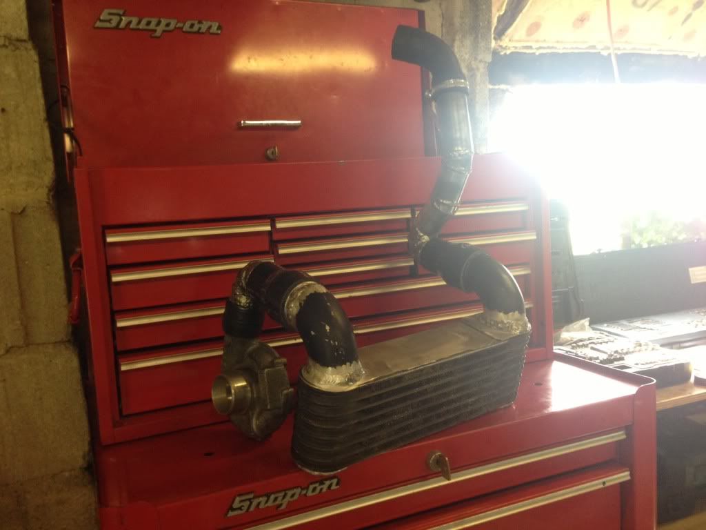

Right well as I said, the wonder that is Dave sorted the intercooler for me as you can see

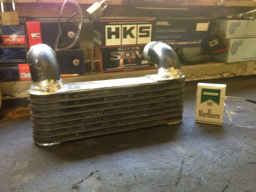

And whoop whoop, the finished item... Gotta love his skill!

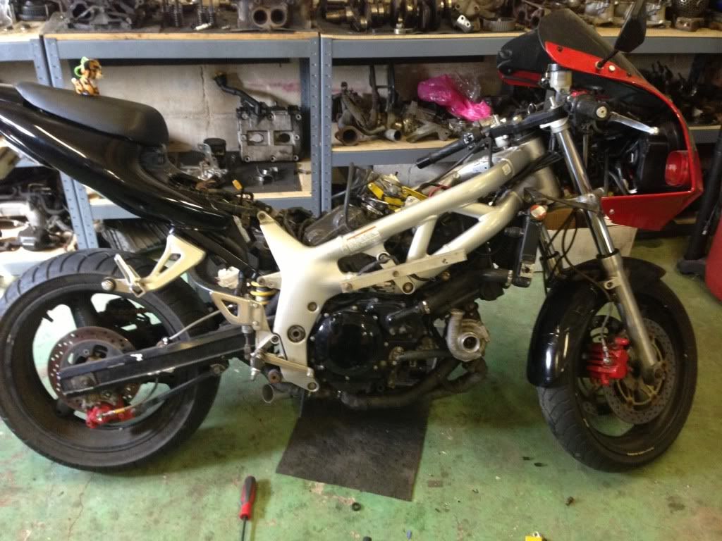

Ok so next dilemma. I looked at the soldering iron and thought 'screw that' so started back on the engine lol

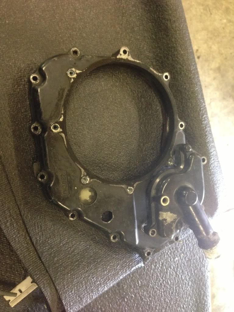

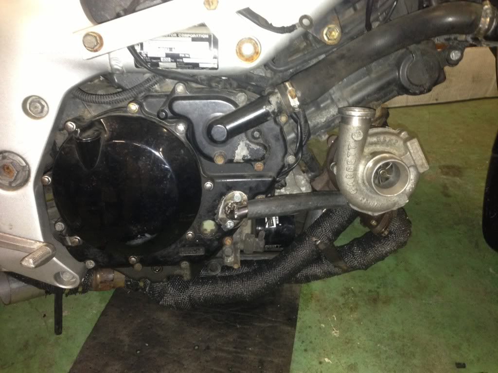

Ok so I have to fit a return feed for the turbo, gravity fed, that enters the oil system above the oil level.
So yup found that and all good on space. Next remove engine casing so we can cut a big hole in the side and ensure none of the filings get left in there.
BUT THEN THIS HAPPENED.........

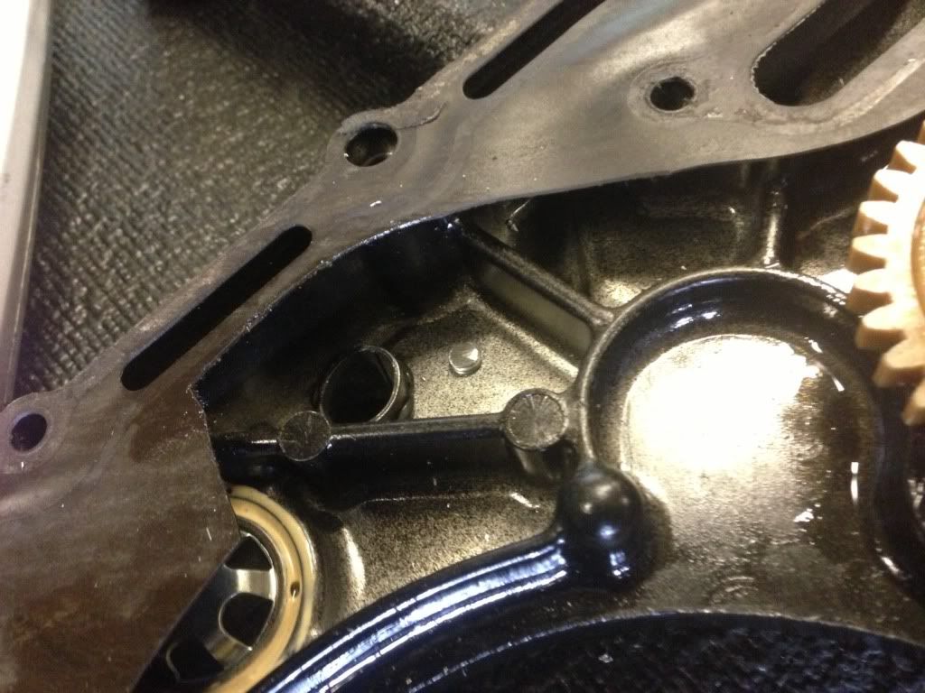

Yup that's right, the lower front of the casing (as you can see) is a WATER JACKET AAAAAARGH!!!!
So I am now sat on the couch indoors sulking and trying to think a way around this next issue
Anyone who wants to bring me ice cream and smokes to cheer me up feel free!!

Ok kids so here goes, finally got over my man strop and hit the garage again. I'd like to take this moment to point out that no one brought me smokes OR ice cream which I'm a little hurt about but hey the story goes on......

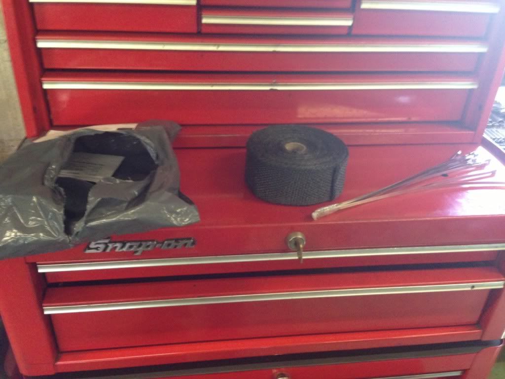

Right so...... Sat on the sofa I heard a knock at the door and it was the postman with my heat wrap so figured as I was up I should make the most of it and get back in so here's a pic of my heat wrap as its awesome!!
Then it was off with the front case, if I wouldn't go in from the front I'd damn well go in from the side so off and a big hole cut as low as possible to allow the oil to gravity feed
If you look closely here you'll see there is a lip at the top where the pipe enters the case, this is to lower the chance if oil draining across the case to back flow into the turbo return pipe. Then on it went whoop whoop!!

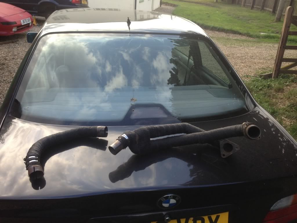

Next I got to wrapping so exhaust off and time to get wet!! Always soak your wrap first, it'll go on easier, you can stretch it and as it dries it'll tighten up round the pipe.
And the pipes on and with the return feed too

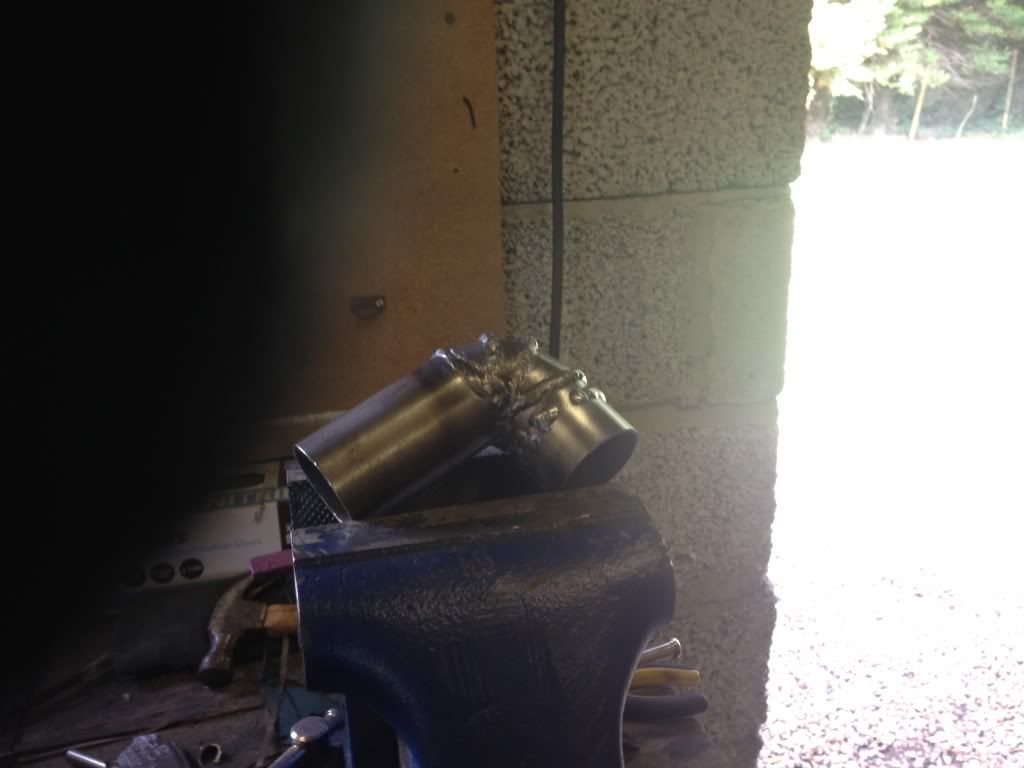

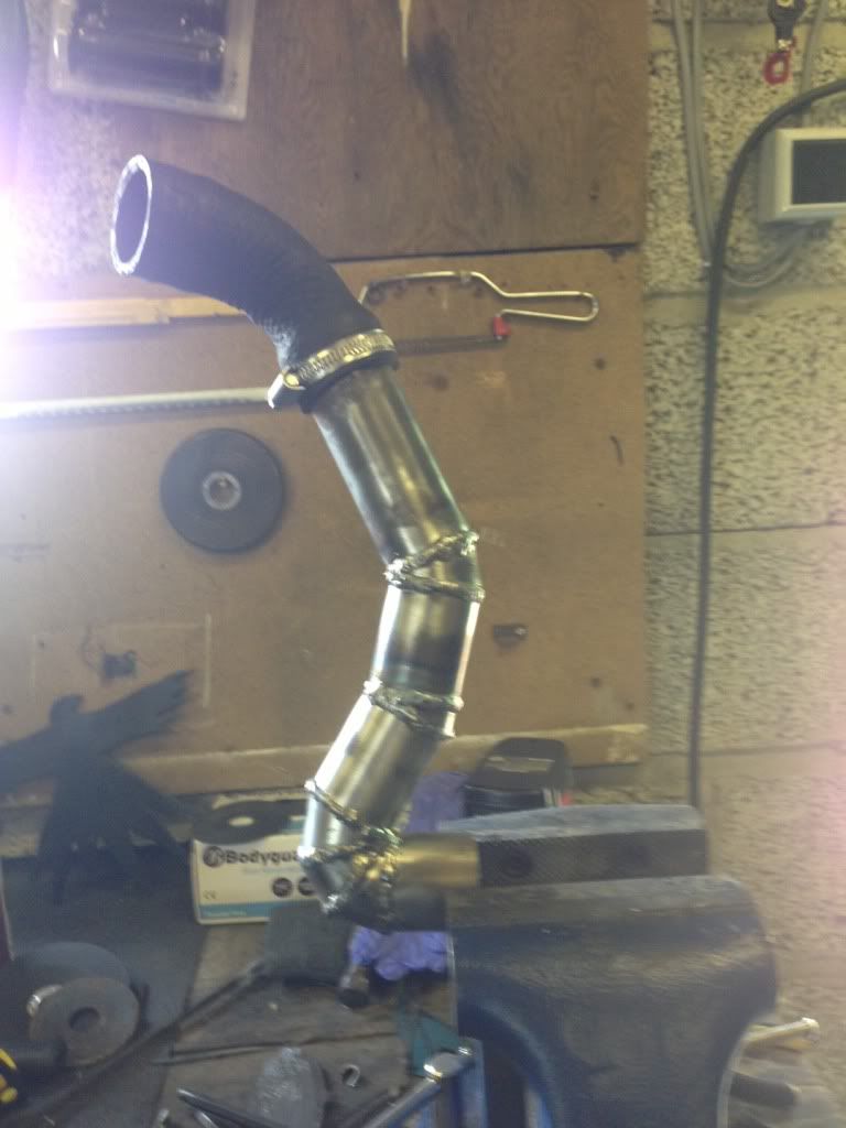

Next cut shape and weld one cold side pipe for the intercooler
Then a hot side pipe to feed from the turbo to the cooler
Put it all together... Looking good!!
Then a little test fit either side!!!
And that's as far as I've got but I'm still at it!!!
Not to bad for two weeks to the day!!!!
