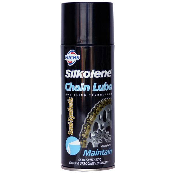

Chain lube is personal preference, so long as you buy a decent brand and apply it as per the instructions. Some prefer wax, some prefer dry lube, I use this Silkolene stuff. You are supposed to apply lube when the chain is warm, but I usually clean the chain when I clean the bike, so want to put my bike away in the garage clean and with the chain lubed and adjusted, so I don't take it for a ride and get the bike dirty again, just for the sake of warming up the chain, and I've always had decent chain and sprocket life.
