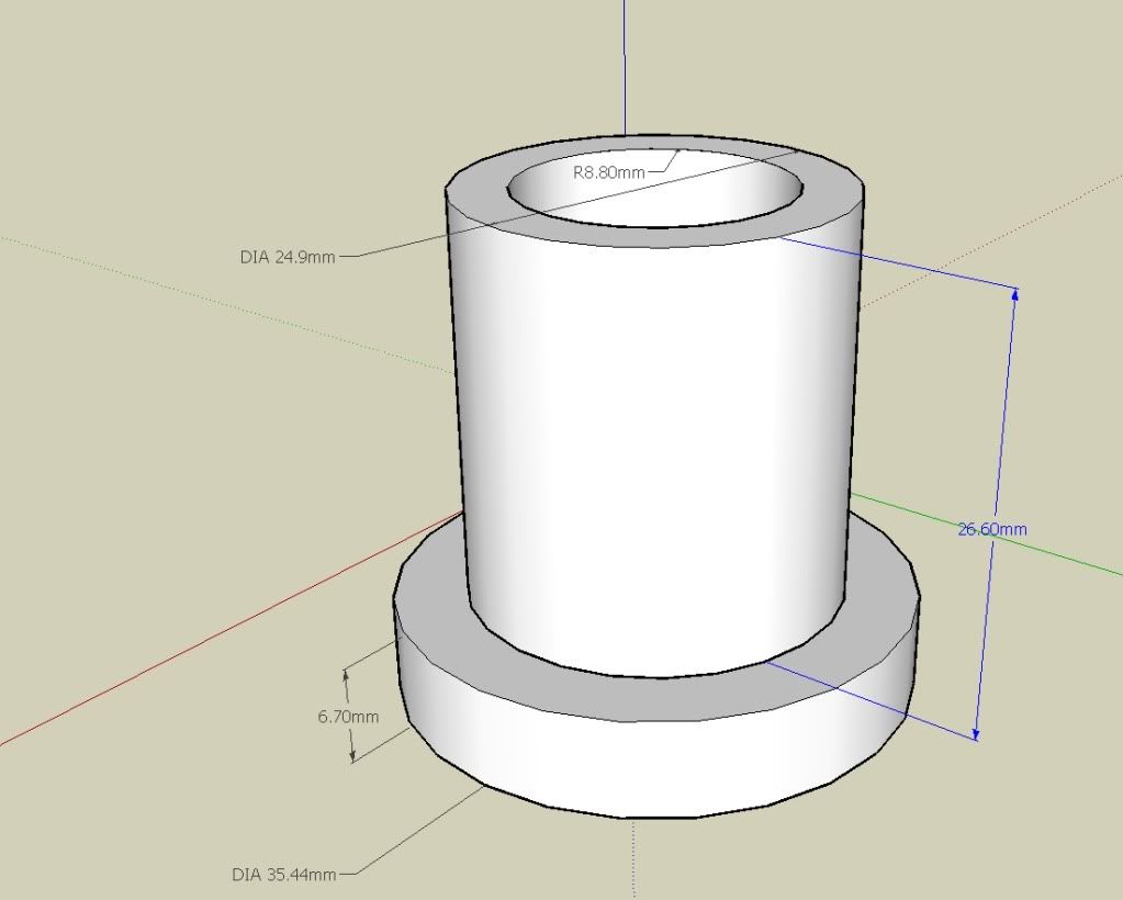

could an enginer give me a ruff price to make this ?

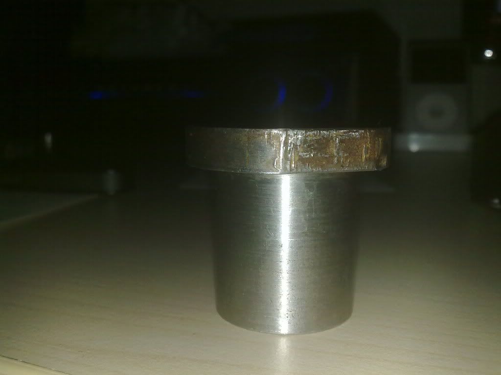

its my axle nut from my front end its custom made so cant just get another one, basically the one i have is steel and rusts alot and axle is alu though so how much would it cost to make one out of stainless steel ?
there is a inner thread not in the image below but the radius is correct then there would have to be a thread tapped in to it its 2mm pitch thread
hears the ruff mock up of the nut at the moment (but without the flat sides or thread) the top radius is the ID of the thread

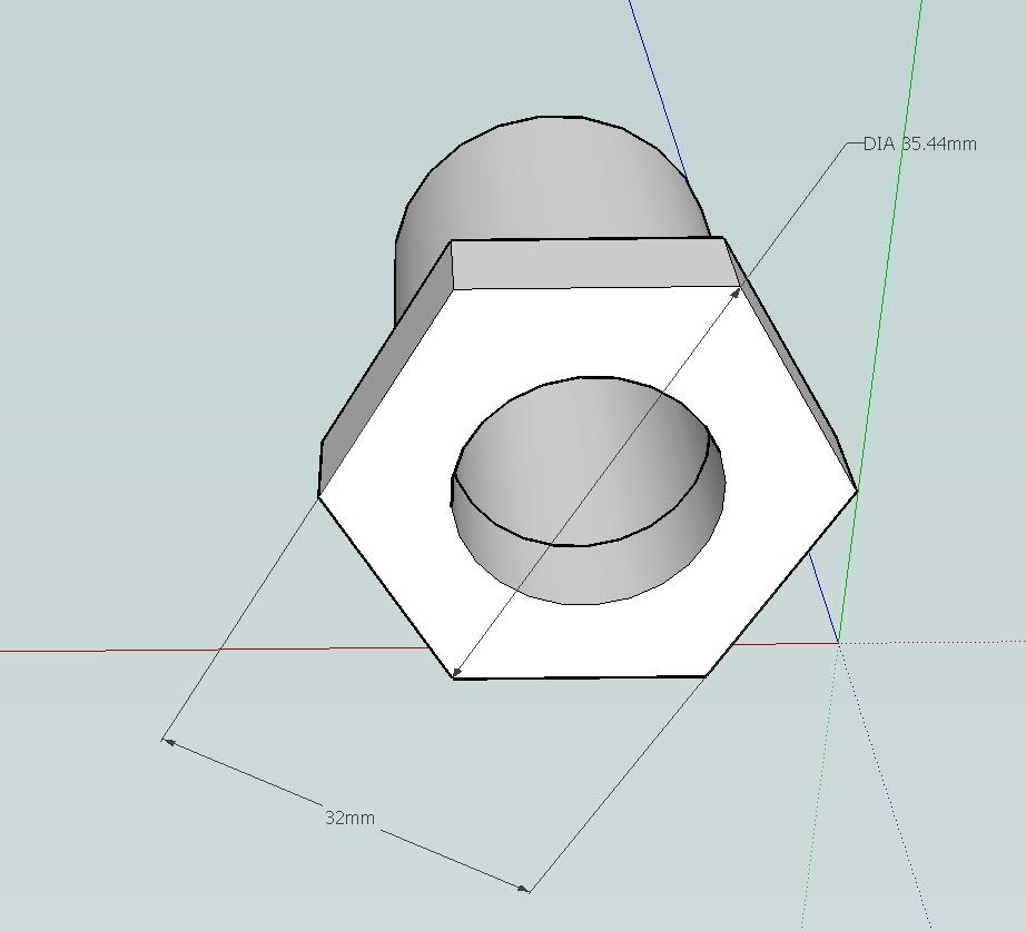

this is how the flat sides of nut looks at the moment but i want it to be a 6 sided nut
six side

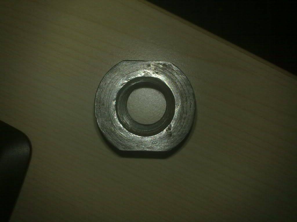

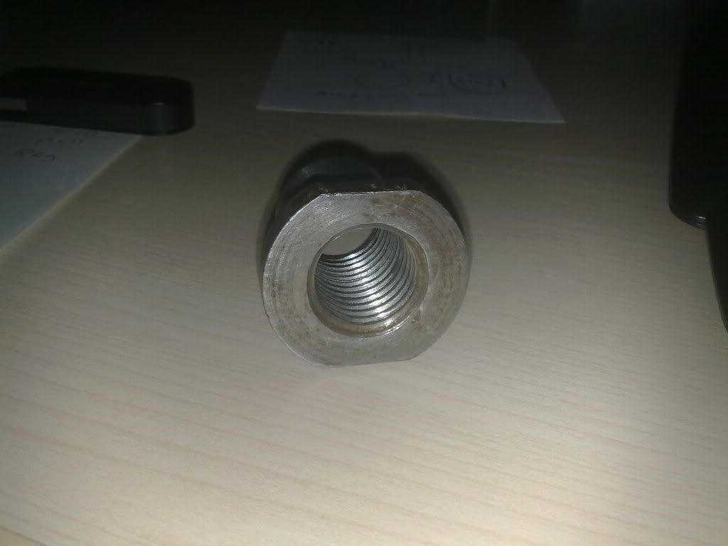

and this is the actual nut

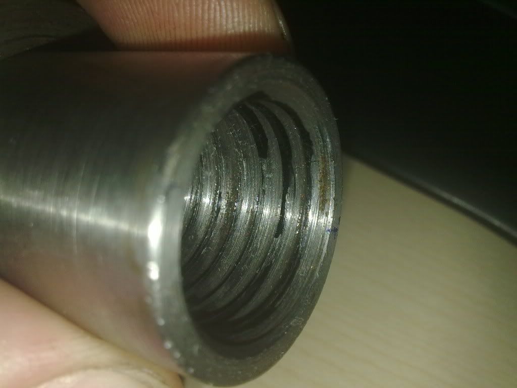

the black bit of pen on the thread gives you an idea of the pitch

Do you know the actual dimensions of the internal thread? I guess you measured the 8.80 internal rad from the peaks of the thread?

yeh, well the thread does not have peaks they are flat but yes 8.8r is the internal thread dimension.

Look at the axle with proper pitch gauge and thread angle tool, who knows what they made if it is all custom.
If you're sending it so someone to turn an internal thread into it then better to send them axle so they can screw it in to check for fit.

If it is 33.3mm long, it looks like it has 13 threads in the nut = M20 x 2.5
Edit, read dimension wrong
yeh there's 13 threads and its 33.3 long so 2.5pitch will go and check again on the axle
Definatly 2.5mm pitch amazing what a little bit of light has on your eye sight
