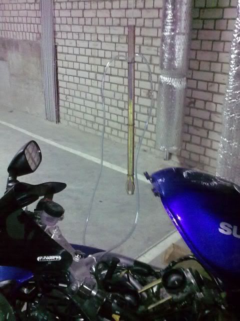

as for vacuum gauges, i used a diy balancer made of a stick and some
clear pvc tubing. i believe it's more accurate than a set of cheap vacuum
gauges. there's plenty of instructions for that on the net. oh, and i even
have a cr@ppy picture!
