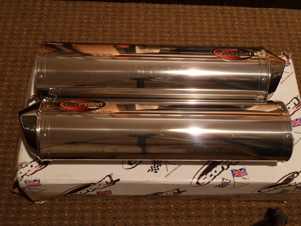

As per title. Has anyone stubbied a Scorpion can? Got one for my new Gixxer but it looks far too long. Same can as photo:
I stubbied my old Viper no problems but the rivet strap on these Scorpion cans look like they are separate to the end plate. Just wondering if anyone had any experience of doing one and does it follow the same principles ie, drill out the rivets, cut the can, put the end cap back on and re rivet? It's a brand new can so don't really want to bugg*r it up

Dan, I did and I didn't
My sv scorpion gained a dink in it on rideout while parked so I drilled the rivets and took it apart.
But I ended up hammering dent out to a good finish so put it back together again

+1. It came apart and went back together fairly simply.

You can also cut a section out (where the strap will go) then weld it up and you can't see the weld because of the strap. Not as neat as drilling out rivets but works just the same

Can you remember what size rivets you used/ ie grip range. I've measured the flange on the scorpion and it measures 6.0mm working on the basis that the flange is twice the size of the hole I'm guessing I'll need a 3.2mm rivet but I'm not sure what length
3.2x6mm grip length is 1.7-3.2mm and 3.2x8mm grip length is 3.3-4.8mm.
Didn't give a toss about the viper on my curvy but I want to make a good job on the scorpion. In fact I'm a bit worried about cutting the can as I'm not sure I'll get a good finish where it's been cut.
