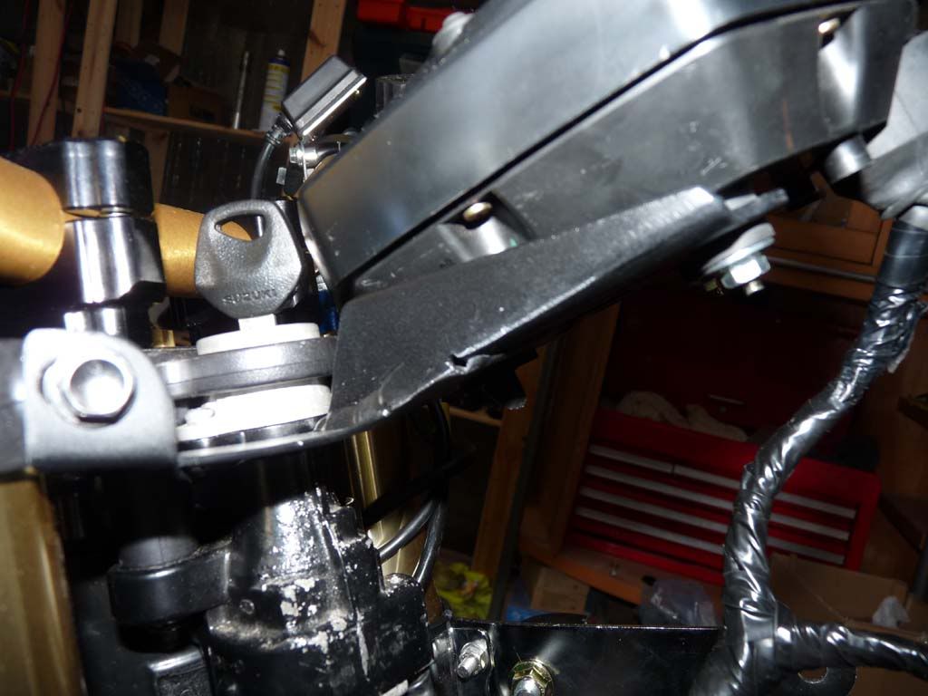

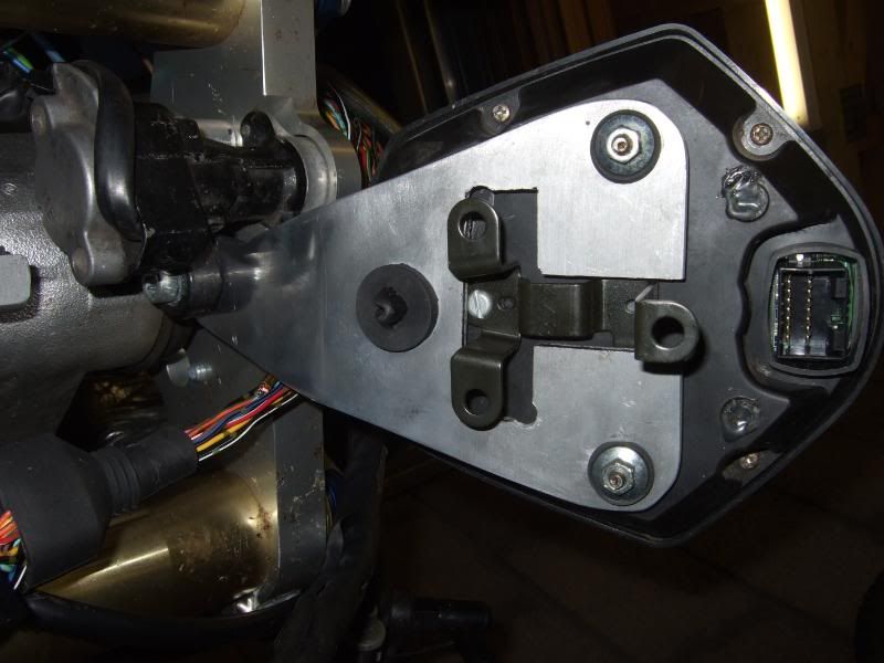

I made a bracket that bolts to the ignition barrel bolts. You'll have to buy the back plastics for the speedo. Have you got standard forks?

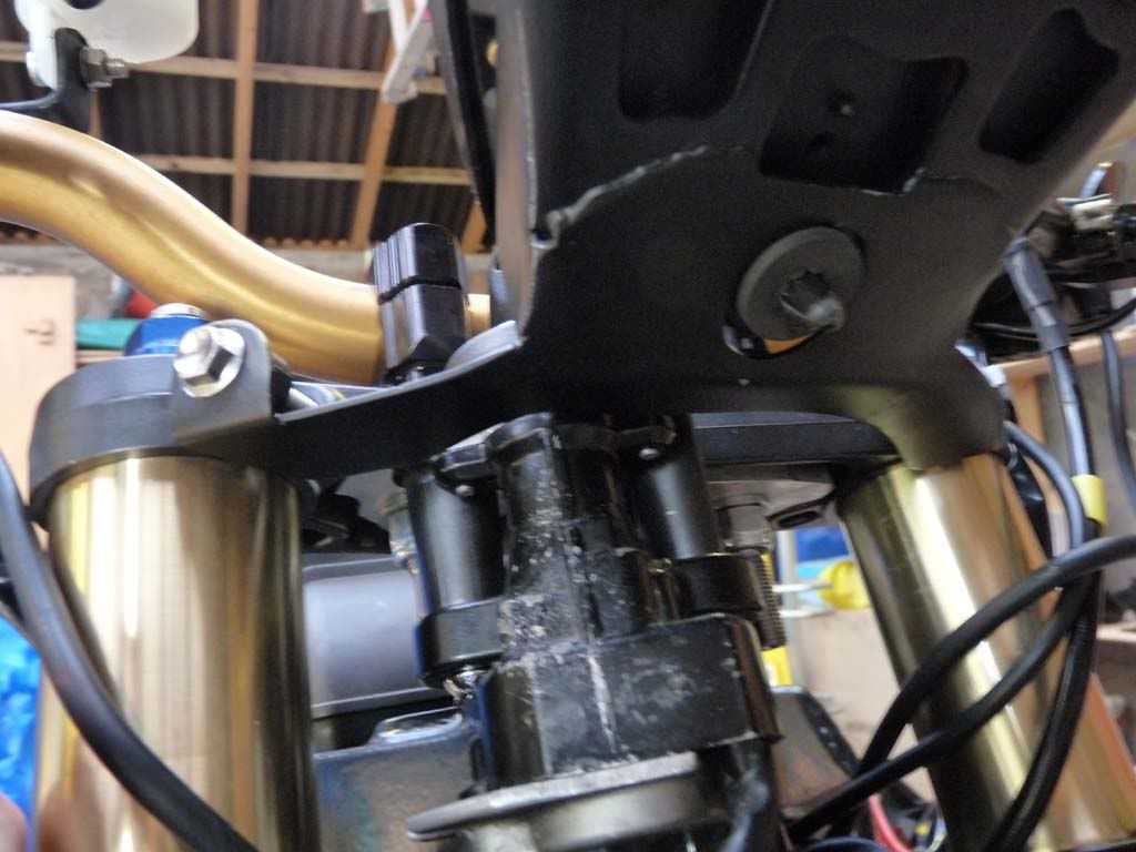

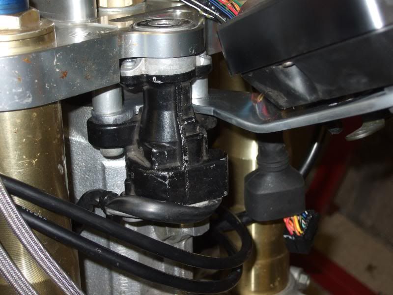

I'll get a photo of mine in the next few days.

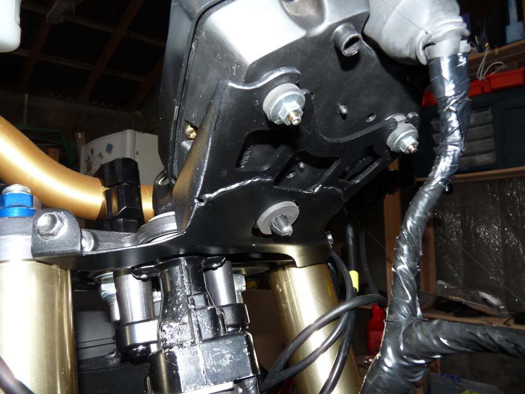

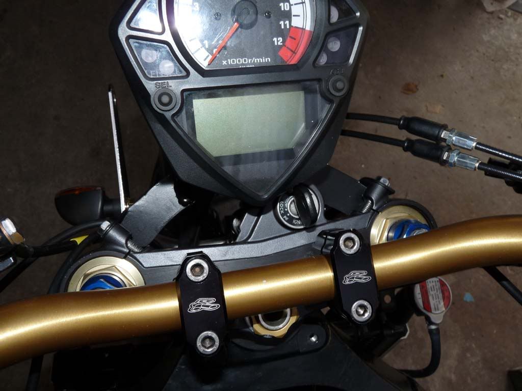

I grinded the centre of the speedo mount out of the old hideous headlight frame, then re-welded it to a shaped bit of steel sheet, bent to the right angle. I needed to strengthen it with gussets cos it was wobbly at speed though. I then bolted it to the yokes using the bolts that tighten the top yokes to the fork. Haven't bought anything else, just modified what I had.
I'll see if I can get a pic up soon.

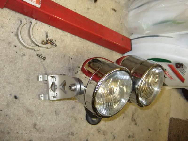

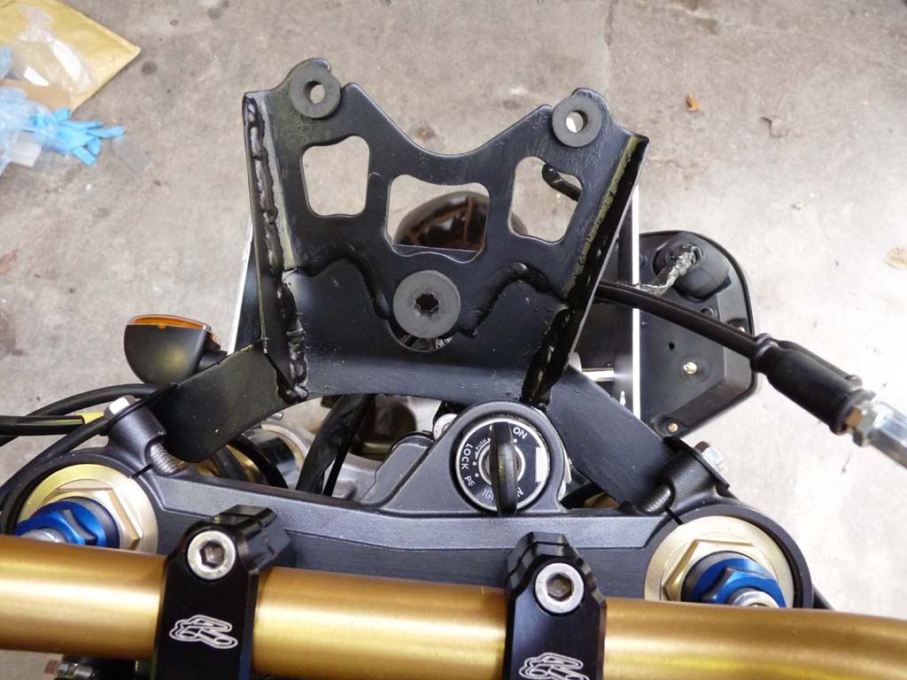

The dominator brackets won't be any use to you. They are for 54mm forks. About £30 for the lights posted. Have you got heated grips? I've got another clock bracket the same as this one that I made with an extra bit under the clocks to mount the heated grips controller, but I took it and the heated grips off today.

I'm a bit busy just now. I'll try get a pic tomorrow of the other bracket. How soon do you need the lights? I'm can't sell them straight away because I still need them until I get my new lights sorted. I think I've still got the original dominator wiring that just plugs on to the 3 pin headlight connector

Got photos earlier than thought. As stated, its 2mm steel sheet, with grinded and filed centre section of current headlight frame. I used this as it retained the existing rubbers to mount the clocks to. Its got a slight bend in it for the angle, and two gussets in line with the speedo to stop it flapping about.
