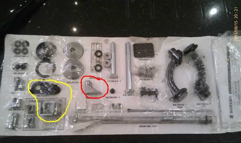

Hi i have bought SV650s lower fairing; it did not come with any fitting kit or bracket. I have checked with Suzuki they don't sell the kit separate, its cost fortune to buy them separate.
Is any one selling or know any fitting kit for SV650s for sale?

Just sold a kit!
If you're looking to use R&G's then I 'think' most of the rest of the kit can be made up using home made brackets and generally available hardware. It's a bit of a faff, but certainly possible for way less than the £100 quid Suzuki charge.
If you can find someone with a copy of the fitting instructions, you should be able to work out everything you need.
The radiator brackets and the lower LHS bracket (shown circled in yellow) can be made up with some cheap strip ally from B&Q for around a quid. The only other one you'll struggle with is the RHS bracket (shown in red), but I'm sure you could figure summat out.
You can get all the grommets here =>http://www.mossplastics.com/standard-grommets
The large ones where the fairing brackets go are part number 15104 (x2), the other grommets are part number 10770 (x4).

Really appreciate it mate! i have found the whole kit in a shop in Hyde but its about £123 quid. i had go to make a LHS bracket but didn't get it right. i will give it a try... cheers..

I made one this morning, took me about 5 mins.
The RHS one is the one you might struggle with.

Can't be sure, but it looks like they just replace the flat/ slightly conical fitting that you get as stock. So my guess is that you still use the completely useless stock arms that fit between the frame and the fairing.
So in the event of an off, you'd still likely trash your fairings.

The other bit you may struggle with is the plastic bit (and clips) that joins the two sides under the the exhaust down pipe.
