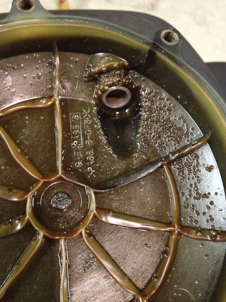

I had a leak from the clutch cover so I bought a new o-ring and some instant gasket.
Took off the cover to clean it up and it looks like this, is this still usable? It seems really warped
It's melted and pitted inside, is this normal?

Wow, that's melty. Mines done 32k with no signs of melting whatsoever. Abnormal I'd say

+1 what hol said. Wonder how its got that hot?

Too much oil? Too little oil? That's all I can think, unless you redline everywhere for hours at a time!

Mine doesn't look like that on the inside

Engines been stood for 6 years. I've only run it with the correct amount of oil at all times since putting the bike together. I have a spare engine, might take the casing off that and see if it's any better.
