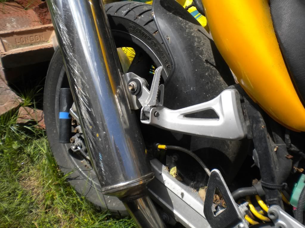

Hi folks, trying not to get too hung up on cosmetics before the bike is on the road but this HAS to be sorted ASAP. I've gathered that the exhaust isn't a slip on so what are the options to sort this sorry mess?

Chop it off and fit a slip on
Empty carbs of old fuel and change fuel in tank.
teaspoon of oil down the bores
Change shock, OEM is carp
New brake fluid & service calipers

It's stainless so you could file, wet&Dry, then polish off.

Tahsnks MJC-DEV. Didn't stop to think about refubing the can - Good call. I suspect a new can will arrive sooner rather than later but a couple of hours work on what's already there will give the beast a massive list.
