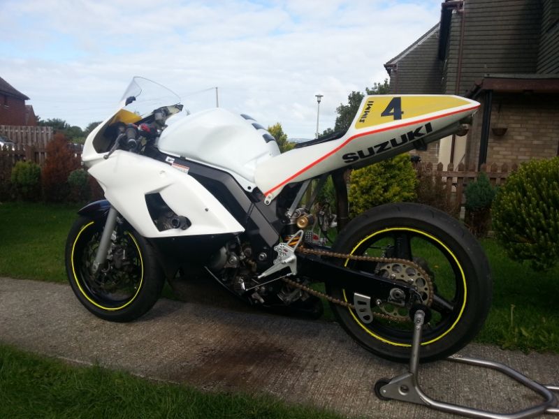

I'm now the owner of Berlin's old SV650 racebike:
Although we are getting on well together, having done a few race meets with pleasing results, there seems to be a slight issue at about 10,000rpm in the higher gears.
I noticed it at the last Aintree round, where having got from 20th up to 4/5th I was having what felt like a hesitation down the massive back straight, it was only slight but was happening around 9500-10,000rpm (I had time to look, Aintree's back straight is about 1/2 a mile long) and it just felt like it was holding back every couple of seconds or so.
During the lunchbreak, I had time to go through everything, it all looked ok, changed the plugs, checked the filter etc and nothing obvious.
Does anyone have any ideas? It does have an occasional Fi light, and the needle goes up to 7k with the ignition on and engine off.
Remap maybe?
Cheers
Paul
