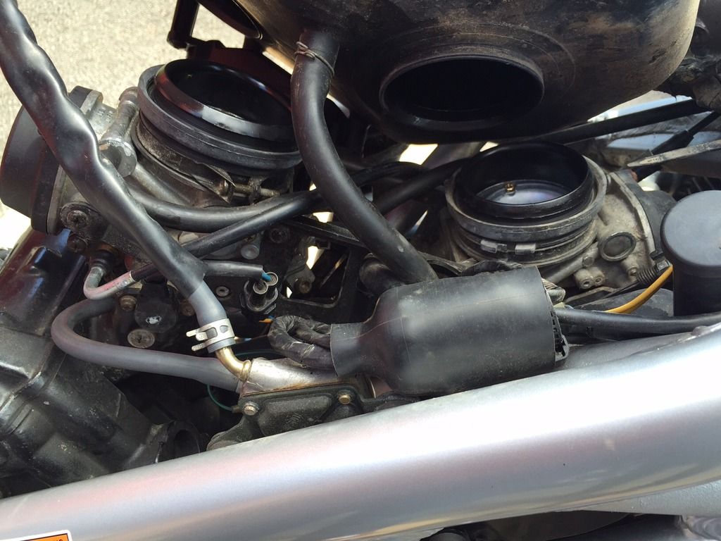

Everyone keeps telling me to drain the carbs/float bowl - does anybody know which screw it is?

they are Allen head bolts look at the bottom of the float bowls and you should spot them.

I cant seem to see them (or I am blind) have looked everywhere for a photograph but nobody seems to have one labelled up

They are located in the middle down between the carbs, there the only Allen head bolts down there, you can see one of them in the picture you have posted!
I undid this bolt quite far, and nothing seemed to run out

sounds like your carbs are not getting fuel, you could try pulling the fuel hose off at the carbs and feed some petrol in via a piece of hose on a funnel to see if she will run, if it runs you would then just need to work your back through system to see whats restricting the flow!.

Which means there was no gas in the float bowl.
BTW, I can't see the float bowl drain screw in the picture.
Anyway, either your vacuum operated petcock isn't working, or the outlet from the fuel tank is plugged, or the inlet to the petcock is plugged. Or there isn't any fuel in the tank.
If you pull the vacuum line off the rear carb, the one that runs to the petcock, you can open the valve (if it's operating properly) by sucking on the hose. If you also remove the fuel line at the carb end and hang the fuel line low enough so that when you suck, you can see if fuel comes out of the line or not.
If it does, your petcock and tank outlet are OK. and it will be on to the carbs.
