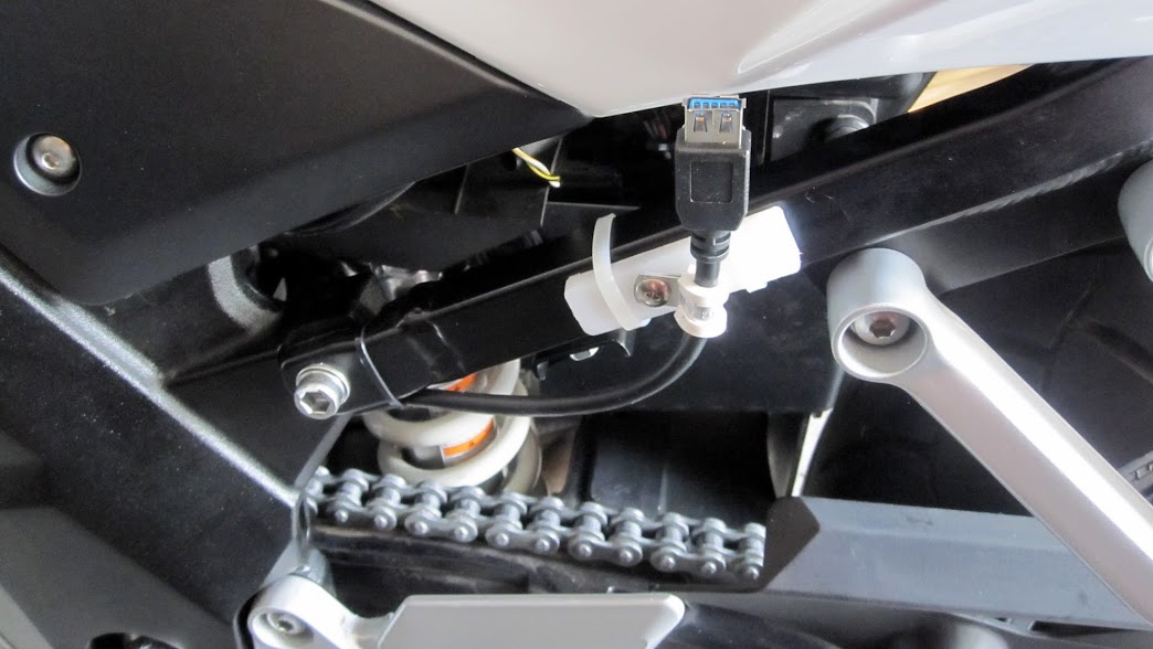

So, I'm just loving my Mobius Action Cam. But, it's a bit of a maintenance chore to make sure it's turned on, charged etc. I have a capacitor pack that I purchased for use as a dashcam. The configuration utility allows you to set the camera up to start, when power is applied and shut down when disconnected. That makes sense to my age addled brain. When going for a ride, just plug the dangley thing that''s hitting your backside and go. When finished the ride of a lifetime, discover that something is hindering your dismount and disconnect the dangley thing.
First step was to bake a male/female USB cord in the oven to make it into a curly cord. Then some shrink wrap to attach it to a male to mini USB cord.
The mated cords are velcroed to the helmet so some strain relief is employed. I've started to use the weather resistant cover on the Mobius full time because of the noise attenuation. I had to cut a flap in the mini USB area.
A two port USB power unit is plugged into my 12V receptacle.
I ran a short male/female extension and tie wrapped it to a frame member.
And now I'm one with my SV650. Peace to all.

The continuing miss-guided installation continues. The third time I dismounted with the curly cord hooked to the on-board power, I broke the female end on the USB cable. Now, with a new one installed, I used an aircraft cushion clamp and some of my never ending supply of UHMW PE to mount the new cable. It has full adjustment capabilities and will auto disconnect when I forget. I over stretched the coiled cable so that it follows my back loosely and presents no interference with the helmet. I want to keep the dangly cable hanging off the helmet so I don't forget to connect. This seems to be an ongoing theme
