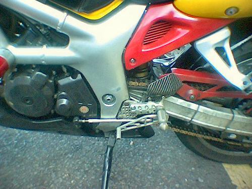

There is a tailor made spot on a curvy to mount the Scottoiler reservoir. On the left hand side, remove the little black triangle trim panel under the seat, feel on the back of the frame and you will find a 10mm threaded hole. Bolt the scottoiler to this. Below is a post from waaaay back showing this.
Originally Posted by TSM View Post
Yes the colour is odd, it not that anymore.
HTH
