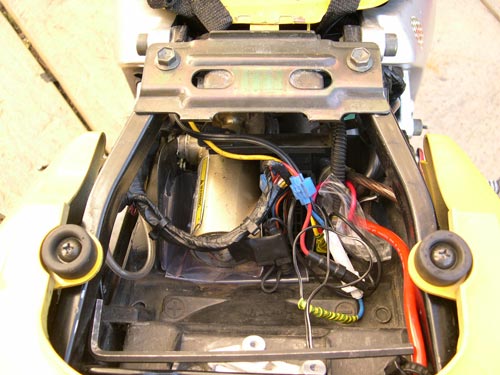

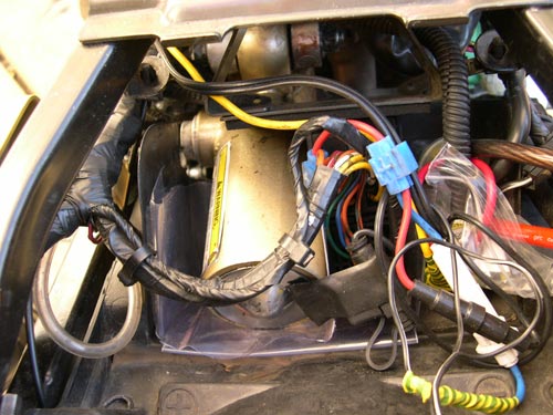

Pics that show the extent that the 636 shock takes up in the battery box.
As you can see in the first picture, the shock extends to the rear of the battery box, the adjuster to the left side.
The fuse/relay unit has been put to the right side of the shock. I have placed clear plastic behind the shock, because i had to cut the battery box to fit the shock this let water in so the plastic is there to cover the hole in the box.
There is also thick plastic between the shock and the fuse/relay unit. On the right is two connector blocks where i join the battery cables which go up to the rear seat where the battery is located.
It is a bit messy but it works, i do have extra connections for the heated grips, horn & starcom system.
The fuse/relay box is placed over the top and the tool kit is stored under the front seat.
Yes, i keep a spare allen key set under the rear seat so i can open the front seat.

That's a pretty good solution to your problem I think... My underseat wiring looks a bit like that too
