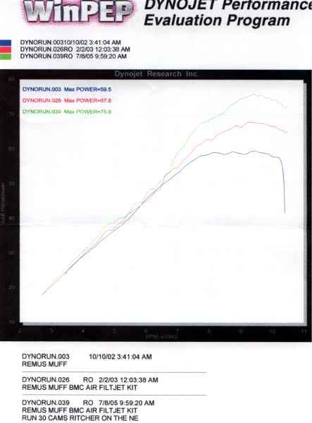

Righto, first here is a graph from my bike, the bottom curve is std with just a pipe. The middle curve is after fitting a jet kit.
As you can see quite clearly that's an extra 9hp at the rear, or something around 17%.
The settings and parts I've used are contained in the 'adjusting needles' thread and as stated provide you with a starting point at least. Shop around for parts and there is usually some place or other having a sale on filters or something so you can save some $$ there. Just take note of the part numbers as this, especially with the filter, makes a huge difference.
