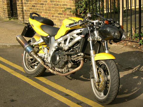

This is what an SV650S looks without the fairings.
