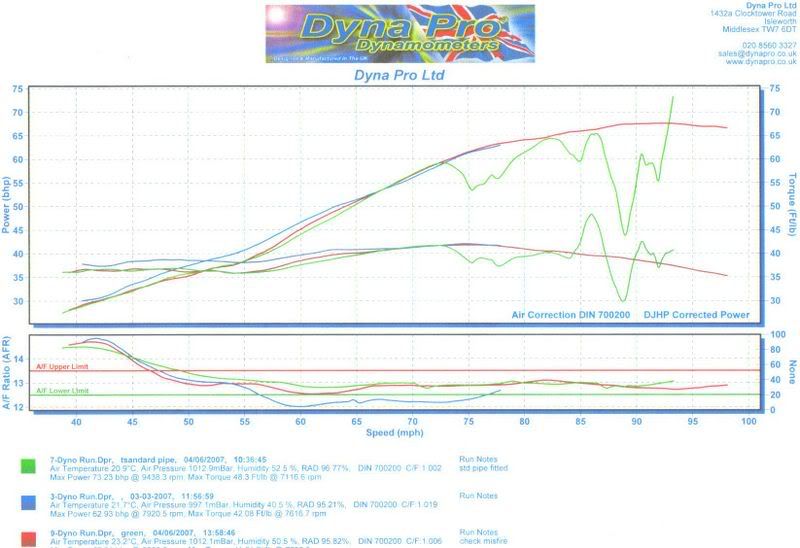

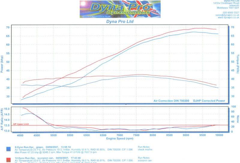

Perhaps I should’ve mentioned what I’ve already got: :rolleyes:
  • Titanium Scorpion can which I had dyno’d (see below) I think they had to change the jets but I think this was more to smooth things out??
  • Gone up one tooth on rear sprocket but maybe looking a 520 kit?
  • I’ve got a K&N air filter but was considering a BMC air filter, dynojet kit & then re-dyno’d??
  • R&G crash bungs (the main ones & exhaust, but was considering fork & swingarm protectors?)
http://i106.photobucket.com/albums/m...g?t=1194957940
http://i106.photobucket.com/albums/m...g?t=1194957992
