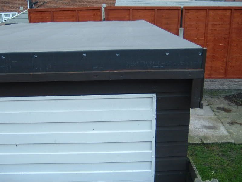

kwak zzr 24-11-08 03:18 PM
Re: So I've got a bit of a leak in my garage roof... but there's no hole or crack?
http://i86.photobucket.com/albums/k1...r/DSCF0008.jpg
http://i86.photobucket.com/albums/k1...r/DSCF0003.jpg
http://i86.photobucket.com/albums/k1...r/DSCF0006.jpg
http://i86.photobucket.com/albums/k1...r/DSCF0002.jpg
Paul the 6th 24-11-08 03:49 PM
wow kwak! that looks bang tidy. I'll try the super sludge glue stuff everyone else has recommended first then see if I can afford that fancy stuff :D no problems with it flapping about at all then?
kwak zzr 24-11-08 03:55 PM
narr, its quite heavy stuff and i sealed all the inside with that expanding foam stuff, my garage is only one of those prefab ones but its dry now :)
