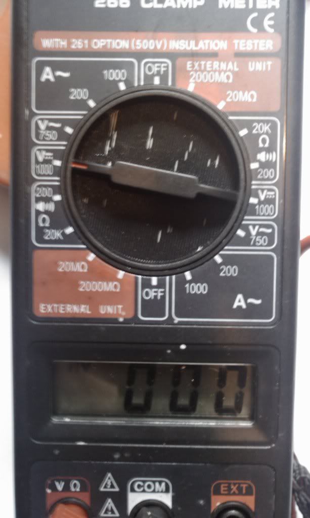

Right my multimeter doesn't have a 100v scale and I'm not entirely sure it was set to AC but I used it on this setting
http://i243.photobucket.com/albums/f...6/IMAG0127.jpg
and got 0 at each pair of pins
yorkie_chris 12-04-09 12:36 PM
Re: What now?...electrics
Wrong setting, turn it clockwise one click. It appears that's the DCV setting, so averages out to 0v with AC.
