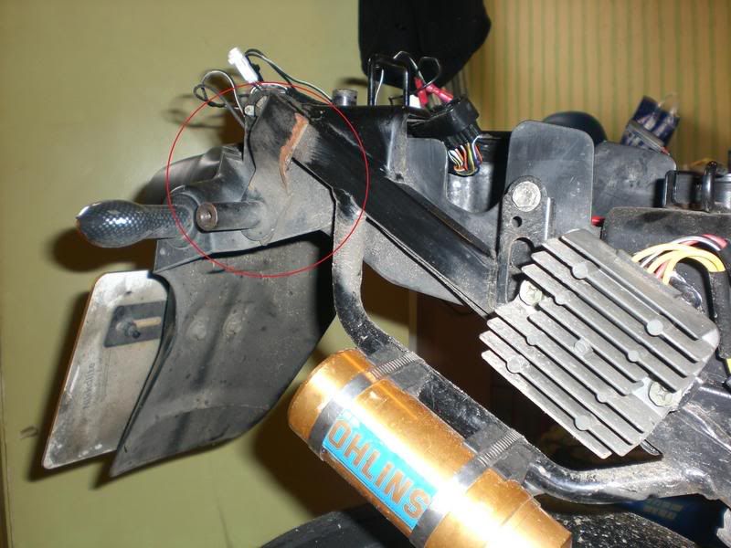

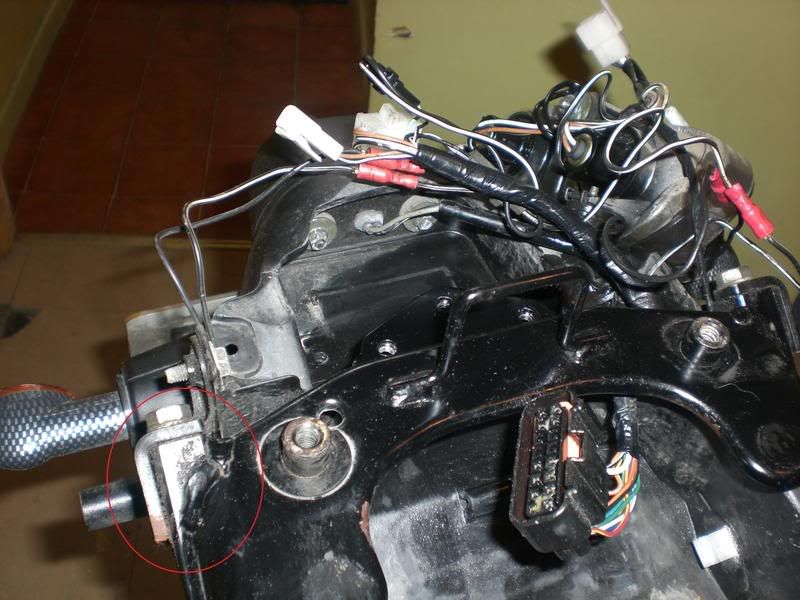

Pic of rails and top plate.
The end of the side plate uses one of the pillion hanger bolts so that's easy. The other bracket is put in the end of the subframe which is hollow square section. It consists of the mounting plate and two triangular shaped wedges with a thread that once the bolt that secures the bracket to the s/frame is tightened up they lock in place. Haven't got pics of the bracket off the bike because it's easier to leave in place and quite unobtrusive. However bracket insitu pics below. Might be easier to see if Givi sell a mounting kit.
HTH.
