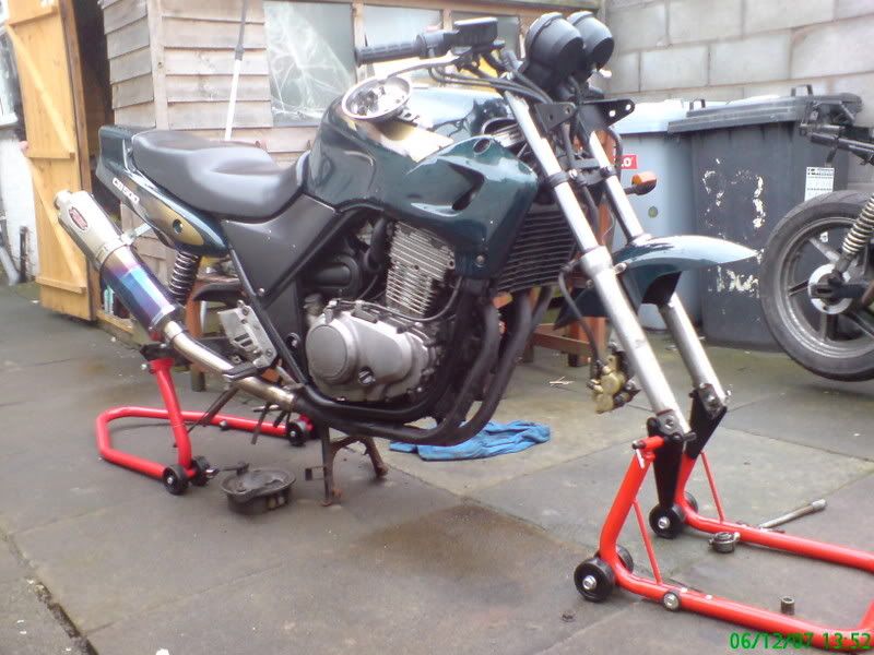

That looks like the same paddock stand as mine. I think they are Micron ones. I have used them on my CB500 and they seem fine. The front one is quite tricky to use as it has one adjustable side which has to be tightened very tightly to stop it rotating as you put the bike on it. Have used them to remove both wheels at the same time, with no problems.
