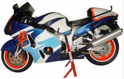

I'll be changing the rear shock eventually, once I've done the forks. I'm going to buy an Abba superbike stand to do the forks:

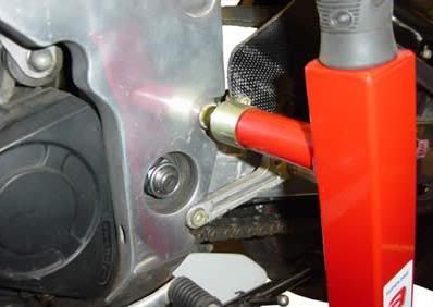

It says that I can buy a "Swing Arm removal kit" at the same time as the stand for £14.95. Or it is £19.95 normally.
Here is the "Swing Arm removal kit":
Do I need the kit to just remove the rear shock?

No the swing arm stays in place!!

I'd say get the kit and take the swingarm out at the same time.
It's a bit more work, but IMO worth it to get some grease into the bearings.
Agreed. This is something that never gets done. For the cost, I think it's worth it.
Old 28-12-07, 07:03 PM   #5
Default Re: To change the rear shock, do I need to remove the swing arm?
I did it when I first got the bike, the bearings had a bit of green powder in them
What are suzuki thinking? If I bought a new bike then the first thing I'd do is strip it and get it all properly lubricated.
£15 for a removal kit and 12p worth of grease could save you £100 worth of bearings!

Ok cheers guys I'll get it then.

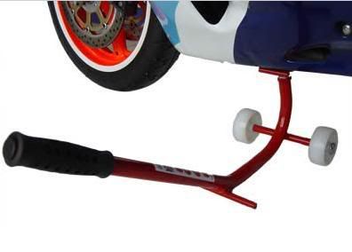

Abba have got a Front Lift, which lifts up the engine:
but at £54.95 it's a complete rip off. So I was thinking about getting an axle stand. What do you think?
Anyone know what height it would need to be to get under the engine?
Old 28-12-07, 07:29 PM   #7
A car jack's easiest, but an axle stand will work too
Old 28-12-07, 07:30 PM   #8
Stig
Hell no. I use a bit of two by two cut to length and prop it under the front cylinder. Total cost. £0.
If you want a race between your car jack and my piece of wood. Willing to take that bet on.

Oh yeh! A car jack makes much more sense!
BigApe, is the bike stable on the bits of wood? I don't want it wobbling about when I'm trying to remove the forks
